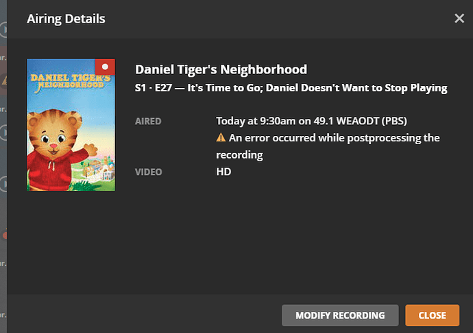

Another one from today:
Happening more frequently. All the same…

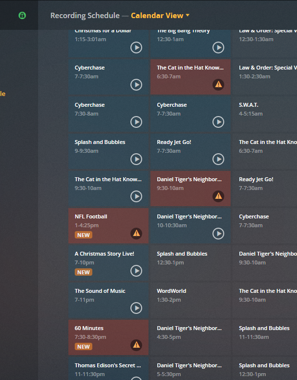

Logs attached for the other failed shows below:
12/17
1-4:25PM - NFL Football
7:30-8:30PM - 60 Minutes
12/18
6:30-7AM - The Cat in the Hat Knows alot about that!
9:30-10AM - Daniel Tiger’s Neighborhood

It shows the same “An error occurred while postprocessing the recording”

Yep. I see the same issue with shows I record for a friends kids. Cat in the Hat and Curious George. TheTVDB seems to have them separated out to their 15 minute episodes but the broadcast station seems to combine the 2 shows into a single episode. For example, in your screenshot the first episode S01E02 - I Love the Nightlife; Oh Give Me a Home is actually Episodes 3 & 4 on TheTVDB.com. Whenever E01 is recorded and added to your library it will show as S01E01 - Show Me the Honey; Migration Vacation which is E01 & E02.
Thanks for the explanation. The kids shows I don’t care much about anyway, just need some content for the kids.
