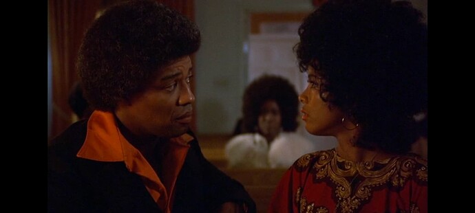

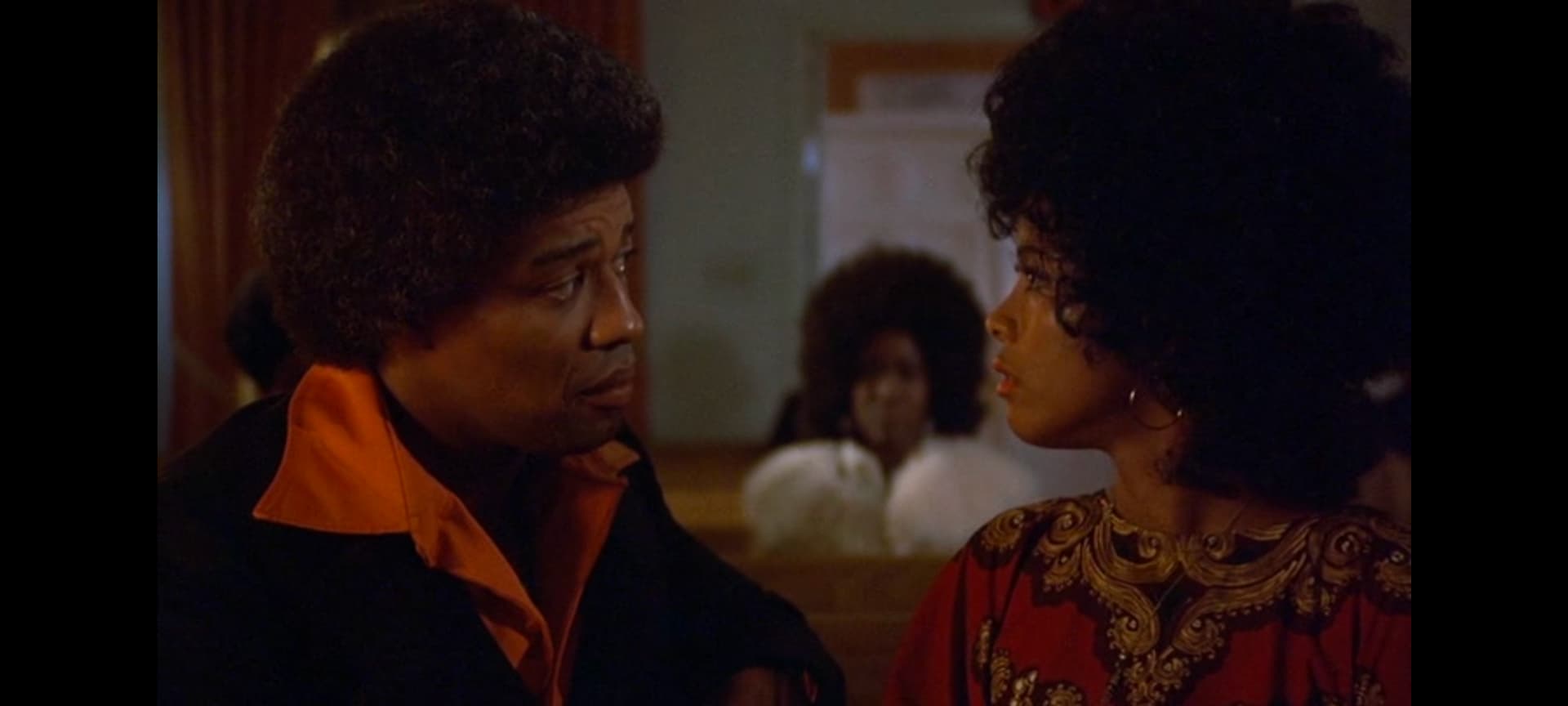

Anamorphic content plays with wrong aspect ratio
Most of my DVD sourced files retained the anamorphic aspect ratio with using DAR for correct playback.
That has never been an issue with Plex, but the new experience app plays those files back with the wrong aspect ratio.
However it seems it may even apply the DAR, but in the wrong direction (making the picture even more narrow then wider).
Screenshots for comparison.
Forcing a transcode is fixing the issue (because aspect ratio problem is caused by the new app).

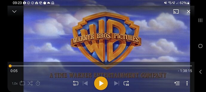

In the new app, during playback tap the vertical ellipsis in the bottom-right as shown in your first screenshot. From there, tap Playback Options -> Display Mode. You should have 4 options: Original, Letterbox, Stretch, and Zoom. Try either Letterbox or Stretch (I believe it defaults to Letterbox already, so try Stretch).
This setting is persistent. So if you play something else back and it looks oddly stretched, you’ll have to change the display mode again.

The issue is clear. New Plex player doesn’t respect DAR value, but plays aspect ratio always as 1:1 instead.
