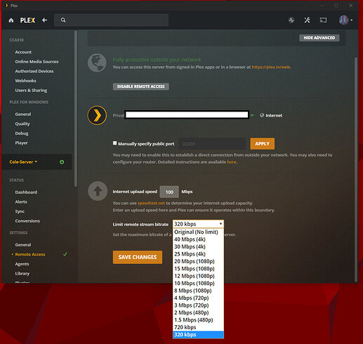

If you want to test the Windows server now, just set the limit to 1 Mbps. That will force a transcode and check if it’s the server having an issue.

So here’s the thing that’s weird about this issue. Different bitrate limits will have different result.
Linux server:
320 kbps: Plays
720 kbps: Plays
1.5 Mbps: Plays
2 Mbps: Plays
3 Mbps: Plays
4 Mbps: Does not play “Error Playback has stoppped because the connection to the Plex Media Server has been lost. Please ensure the server is available and retry”
8 Mbps: Does not play
10 Mbps: Does not play

I set the remote bitrate limit to 10 Mbps and the transcoder does not start
