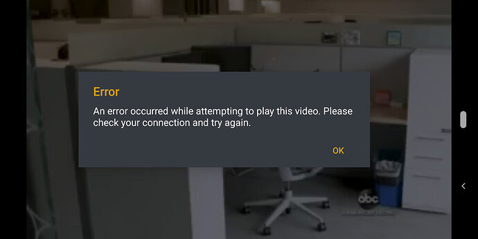

On my Pixel 3 I haven’t been able to play Live TV remotely. Only one channel will tune. I only have problems on the Android app. I’ve tried uninstalling app and re-installing and it doesn’t help.
At 2:33 am, I tried tuning ABC 2.1 which fails, then tuned Fox 11.1 which works, then CBS 5.1 which fails. The only channel that works is 11.1. Again it’s only on the Android app when I’m viewing remotely. If I’m home, everything will direct play fine. I also have “Limit Cellular Data” set to 2mbps and streaming brain limited to 6mbps upload. If I disable “limit Cellular Data” Live TV works as expected.
Logs are attached. This has been going on for a few updates now, don’t remember exactly how many updates, but can regress if needed to find out when it started. I believe around 8.14 but not positive.

Get the following error any time I try and play live TV remotely. If I turn off streaming brain, I can play Live TV again but it direct plays and my upload bandwidth isn’t good enough for that. If I “limit cellular data” in the app, it still direct plays so has no effect. If I lower the quality for “remote streaming quality” to anything less than the resolution I get the error, if I make the resolution the same (even though it’s less quality) it still direct plays.

Your logs show that the app is having trouble decoding the mp3 audio stream. Do you have any videos from your own server with mp3 audio? Curious if your device has issues with the mp3 audio. This is not the same as playing mp3 music. Needs to be an mp3 audio track in a video file.

From your description of playing back the saved version, it sounds like the original is an ac3 audio stream and PMS might be having trouble transcoding that live to mp3, so when it gets to the Android client as mp3, it fails.

First off, are you playing from a remote location? Your logs do show your server is behind DNSRebinding protection so local secured connections will not be possible. You may want to look into getting this resolved, which could help.
Next, I see that the stream was first attempted to be direct played but failed due to a bitrate restriction. This could be due to the issue above resulting in the stream using the remote quality setting instead of the local setting.
Thirdly, I see that the transcode is trying to use the H264 5.2 profile level. It’s possible your device is having issues with this. There is a setting in the Android app to set this. Try setting that lower one value at a time.

With the Pixel 3 android client I tried backing down the h264 profile from 5.2 and it made no difference.
Basically, my only working solution has been to downgrade Plex Mobile to version #8.12.4, so something must have changed between 8.12 and 8.13 and up.

At approx 2:00am I started playing channel 2.1 not realizing I was connected to wifi remotely. The remote streaming quality in the app was set to maximum and streaming brain is set to 6mbps upload and the video played.
I then turned off wifi and played the same channel on 4G with “limit cellular data” set to 1.5mbps and I got the error. Logs are attached.
Also If I turn streaming brain off it direct plays the file even though I have “limit cellular data” set to 1.5mbps

Do you have the PMS logs for that time period? It looks like the app did ask PMS to transcode the file but it had trouble playing back what it received.
I don’t see that in your log. It’s possible that what you are seeing is just a delay in the reporting. PMS may think it was going to direct play at first so that’s what it shows but then will change after a few seconds.
