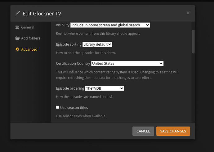

Going over the suggestions in this thread and editing the main Series Advanced settings solved this issue for me.
For the TNG series I changed Episode Ordering to TVDB(Aired)
It’s a bit weird because the first two “episodes” shown are now linked to the same file that contains episodes 1 and 2 combined, but I can live with that.
If Auto Play is on Plex will play “Episode 3” after “Episode 1” (which contains 1 and 2)… so that’s cool.

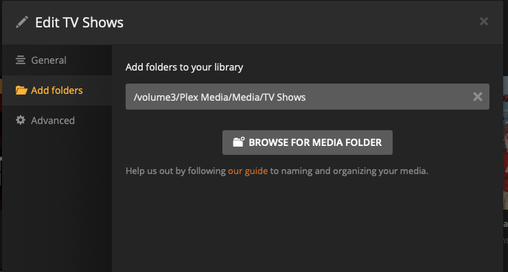

This is where my TV Shows library is. I am running the Plex server on a Synology NAS.
I don’t see anything unusual there. Do you?
Looks good. Like I mentioned, at this point I no longer remember what my thought process was based on what I saw.

For me (being one of the much newer members/Plex users here), “Library Default” was the default, but I don’t know
what “Library Default” refers to.
Having changed to TVDB(aired order), I think all of my Star Trek naming issues have been resolved.
I’m fairly sure this is documented somewhere, but yeah, it’s not clear just from looking at it in PMS. The default is TMDB (aired). I don’t think Plex supports any other sorting for TMDB, unlike TVDB. Someone correct me, if I’m wrong.

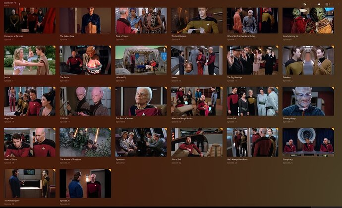

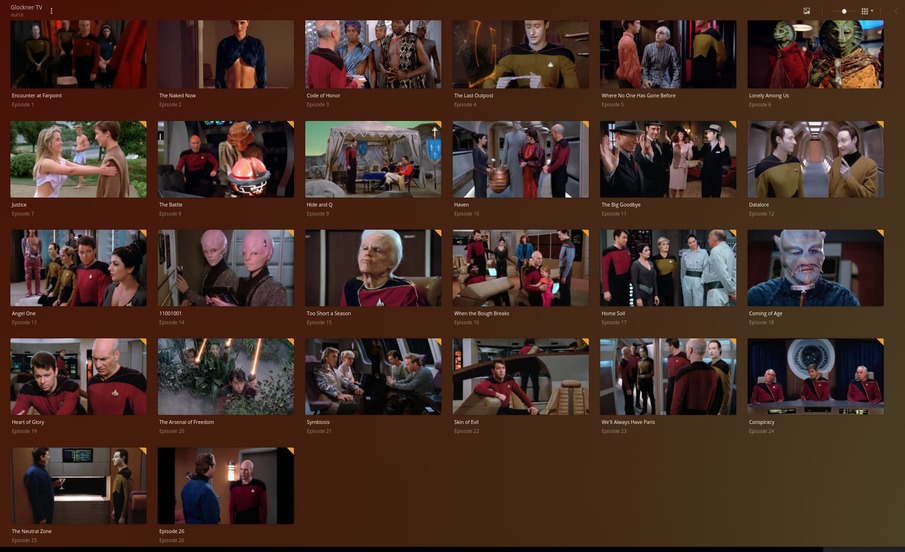

Do I have the same problem as everyone?
Please notice how the alignment ends up with Episodes 25 & 26.
S01E26 is “The Neutral Zone” but the screenshot from Episode 25 is from Episode 26

The shift / error seems to occur right at the beginning with the compount episode file.
S01E01-E02 should get one/ same image. (E02 is actually lost here)
S01E03 should get Tasha’s pic.
