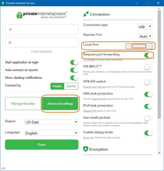

On my router I forwarded port 32400 to 32400 and it works fine without vpn. In pia I set local port to 32400 and turned port forwarding on. PIA says it is connect and gives me a IP and external port, when I try using it or checking it online it says the port isn’t open. I’ve emailed PIA about this, not sure if anyone else is encountering similar problems?
I simply told PIA what port I had forwarded in the box provided and enabled the tic box below. I did nothing else. It was easy. It had to be easy - because an idiot did it in 5 minutes.
I did not forward the standard port. I invented a new one from the range available and instructed Plex to use that port in the box provided (the idiot in me thinks that’s more secure).
Actually, I’m not even sure ‘Request Port Forwarding’ in the PIA Client has to be enabled. Once you tell PIA what the local port is - that might be all there is to it (there’s that idiot thing kicking in again)…

@Uskompuf said:
In PIA windows under advanced settings i set local port to 32400 (for Plex) and set request port forwarding to true.
The local port in the PIA app is for the VPN to use. Nothing to do with port forwarding.
@colinleeds said:
That’s what I think too… now.
Once you forward the port in your router, the PIA Client just needs to know what that port is… I guess.
I disabled ‘Port Forwarding’ in the PIA Client and it’s still working fine here, so that’s all I can guess is happening.
The PIA client bypasses the router. If forwarding ports in your router is making a difference then the traffic isn’t going through the VPN.

I’m not seeing a port number when I do this. “Request port forwarding” is turned on though, what am I missing?
Enable port forwarding in the application by entering the Advanced area, enabling port forwarding and selecting one of the following gateways:

After enabling port forwarding and re-connecting to one of the above gateways, please hover your mouse over the System Tray or Menu Bar icon to reveal the tooltip which will display the port number. You can then enter this port into your software.
Same issue here I tried to port forward with PIA Canada and it briefly says accessible then falls back to not accessible from web. Is their a way to port forward with PIA only using the windows client and no opening of ports on the router?
