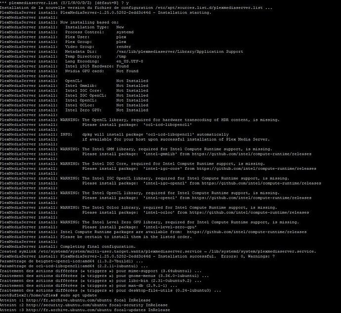

Hello ChuckPa,
So a fresh install of 1.25.0.5282 on ubuntu 20.04.3 / Tiger lake detect oc1-icd-libopencll missing and install it.
The 6 others warnings about intel/compute-runtime are mandatory and have to be adress manually , is that correct ? If yes do we need to manually update them time to time ?
