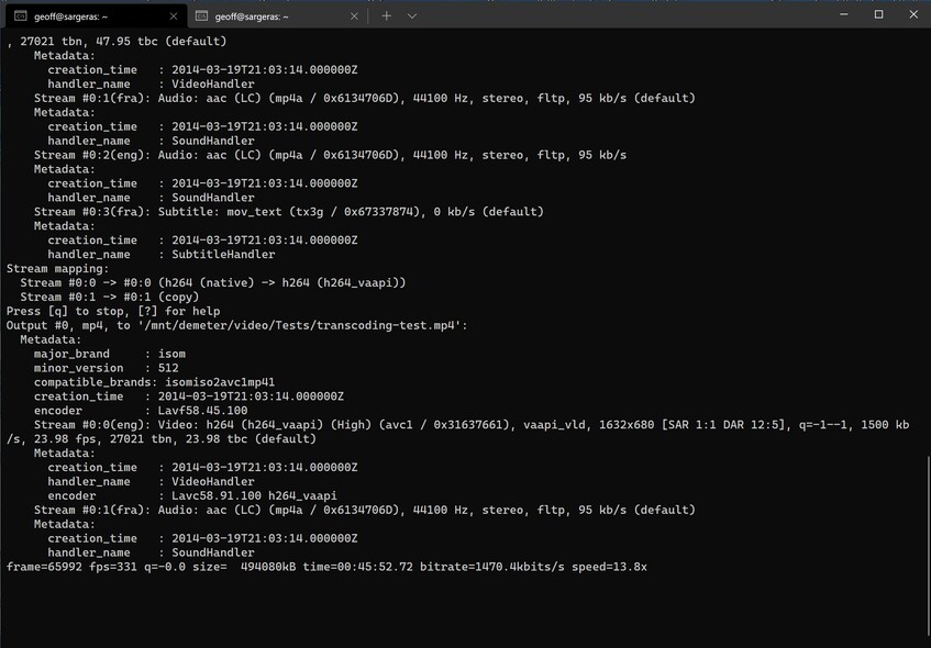

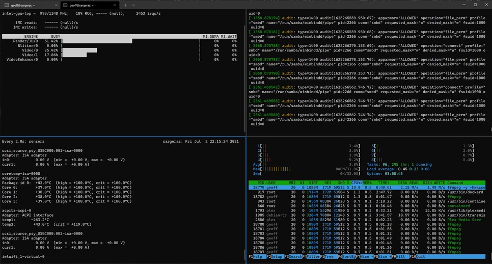

Here’s the command I’m executing (yes, still running):
ffmpeg -y -hwaccel vaapi -hwaccel_device /dev/dri/renderD128 -hwaccel_output_format vaapi -i "$input" -map_metadata 0 -c:a copy -c:v h264_vaapi -b:v $bitrate "$output"
No crash so far, but I’m not making assumptions it’s stable.
I need more aggressive tests.
