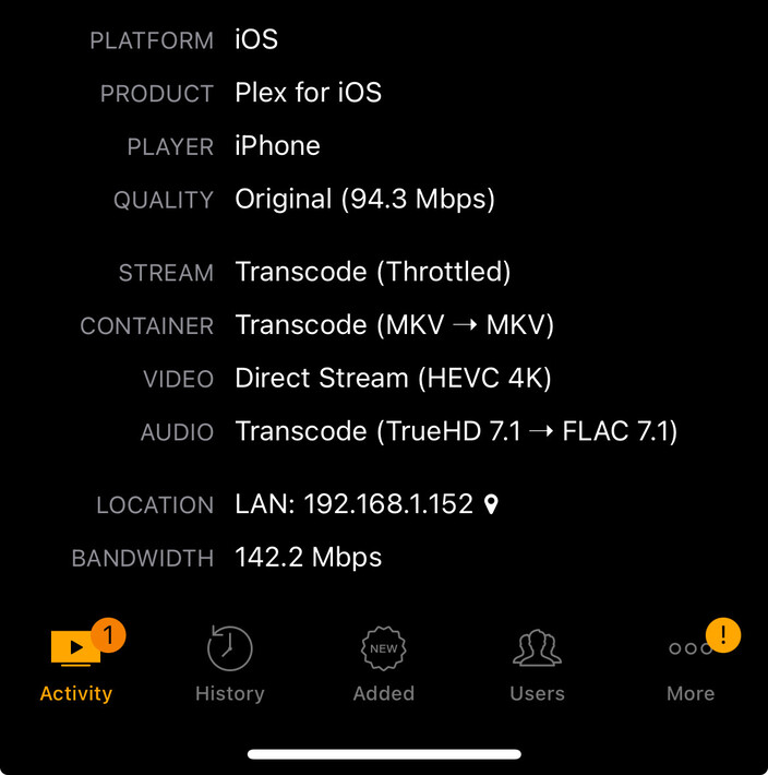

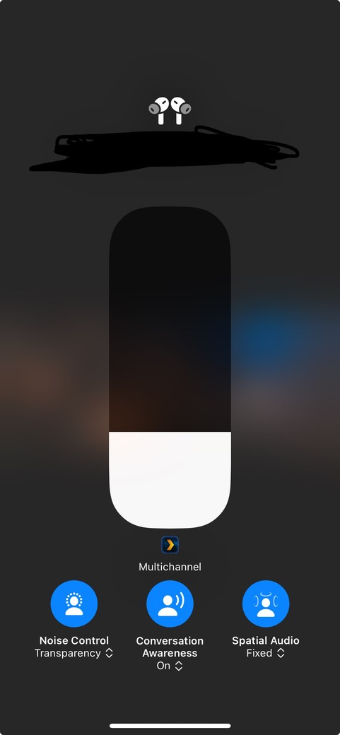

One other note, and this may be an apple API support issue, I am also seeing in this that Spatial Audio on AirPod Pros is only available in stereo on Apple TV 4K running tvOS 16.6, but that it is multichannel on tvOS 18.1. All codecs (except for TrueHD) on iOS 18 are also working as multichannel. TrueHD Multichannel is still transcoding down to FLAC 2.0 on iOS devices, but transcoding properly to Multichannel FLAC on Apple TV 4K. Is it possible to transcode TrueHD Multichannel on iOS to FLAC Multichannel as well, rather than stereo? Has there been any more though to allowing direct play of TrueHD connect instead of transcoding it at all?

If I remember correctly, that issue with transcoded multi-channel content was reported previously as well? Did you try changing the iOS.xml profile for your server and changing <UpperBound name="audio.channels" value="2" onlyTranscodes="true" /> to >= 8?
I just tried that and it seemed to work but I just asked internally why we might be doing this.

That worked. Adding a custom iOS.xml with
<UpperBound name="audio.channels" value="8" onlyTranscodes="true" /> transcodes TrueHD 7.1 to FLAC 7.1.
