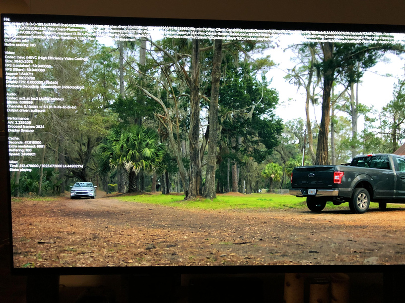

I have a 60fps 4K HEVC/265 HDR file that is transcoding to Apple TV 4K. Audio channels are TrueHD 7.1 and AC3 5.1. It transcodes down to H264 and AC3 for some reason.
All of other HEVC/265 4K content Direct Plays or Direct Steams fine. Is this caused by the higher framerate? I tried the enhanced player and the video and audio were now showing as Direct Playing but the frames were dropping like crazy.
Regular Player
Enhanced Player
Debug (Enhanced Player)

It doesn’t work in the Plex app in ATV, even without transcoding. As the previous posters have said loads of dropped frames. However it does play fine in Infuse, so it’s not an ATV limitation but a Plex app limitation.
Also it’s nothing to do with the audio selected, even with the AC3 track which can be direct played you get dropped frames.

With that title you will have to use Infuse Pro. There is no way to DIrect Play or Direct Stream without dropping frames using the tvOS Plex app.

Please get us the XML Media Info from that file while it’s playing.
Logs would be appreciated. Being a Direct Play, PMS and the ATV have agreed the ATV can handle the original track types, but not necessarily if the track bitrates are too high.
