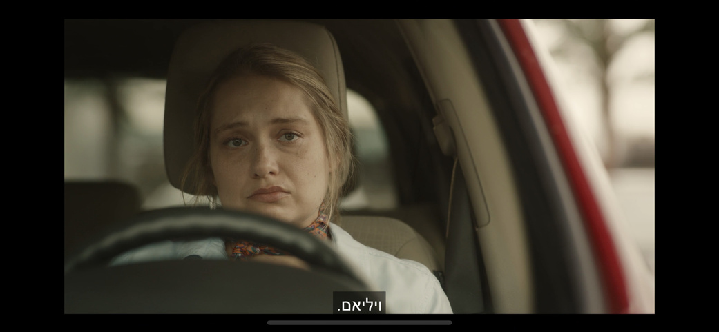

@Idan_Bush I just tested it with the subtitles you shared and it works perfectly in 7.2 both in Apple TV and iPhone/iPad. Check this:
That looks correct, right? That’s the version from the Apple Store for iPhone.

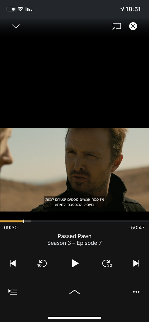

here is a screenshot from my iPhone:
As you can see from the example below the question mark (?) appear to be “bigger than” symbol (>)

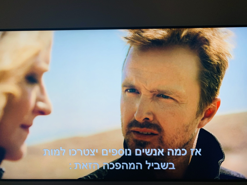

here is a screenshot from my Apple TV:
As you can see from the example below the question mark (?) appear to be “colon” symbol (:slight_smile:

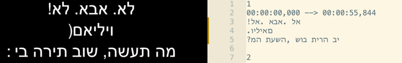

This happening only for specific symbols like “?”, “-”, “;”…
And i think only at the end of row of each subtitle
It seems to happen only when the symbol is not in the first line :neutral_face:
