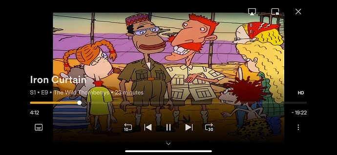

For an episode of a show I’m watching the aspect ratio is normally 4:3. But Plex stretches this to 16:9 by default.
This is happening for all beta version. The last version this has been working correctly is 2025.12.0 (1009).
How it looks in 2025.18.0 (1098):
How it looks in 2025.12.0 (1009):
If more information is required, please let me know!

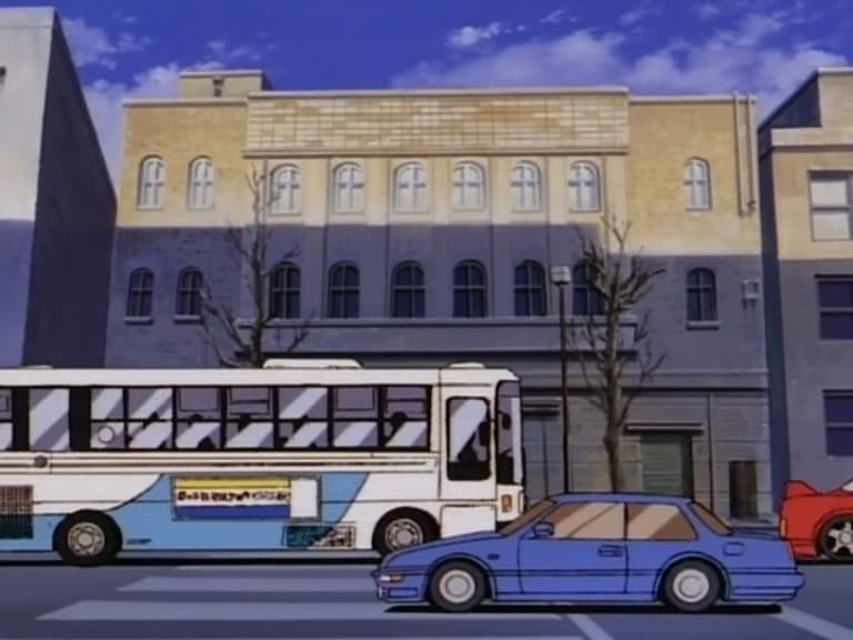

I can’t speak for iOS, but I know the display aspect ratio setting in MKV headers is followed in the Android app, as I have used it to fix playback being wrong for a 4:3 show similar to the OP’s problem. I even remuxed a different series to change a 4:3 series to 5:4, because I noticed the picture seemed to be stretched horizontally in the first few episodes.
Original (4:3):
Retagging in the video aspect corrected it, and resulted in circular image elements (the moon, city lights in bokeh) to all be properly round.
5:4 Aspect:
Interesting. The display aspect ratio used to be ignored. I wonder when that changed. I’ve had to reencode some anamorphic videos because of that. Well if that works now, then that is the simple solution.

Media id="380071" duration="1413686" bitrate="2678" width="1920" height="1080" aspectRatio="1.33" audioChannels="2" audioCodec="aac" videoCodec="av1" videoResolution="1080" container="mkv" videoFrameRate="NTSC" audioProfile="lc" videoProfile="main" hasVoiceActivity="0"
This is a blu-ray rip? It should be pillarboxed with this resolution, so that definitely makes the issue more clear.
This is a special encode of an upscale of this episode in AV1.
The issue might also be that Plex does a wrong interpretation of video file of course. I see in the mkvinfo that the pixel width and height are 1920x1080, but the display width and height are set to 1920x1440.
Lol. That’s one way to call it. Your file lists the aspect ratio as 4:3 then says it’s anamorphic which will stretch it back out. The player might actually be doing the right thing.
See if clearing the anamorphic flag fixes the issue.
I find it weird that VLC and Infuse are both playing it correctly.
I’m just trying to figure out what’s happening here.
Plex doesn’t use every parameter in a file. From what it does use, it appears your file may have conflicting info. If that is the case, is Plex wrong for using the info it got or vlc for ignoring it. :man_shrugging:
This encode is messed up in my book. It’s a 16:9 aspect encode from the XML info, but it was never that aspect ratio to start with. If it had been a BD rip it would have been pillarboxed but the encoder cropped those off (which is common), but then your encode stops being 1920 wide at that point. As a DVD upconvert, it would have been a normal DVD resolution like 720x480 or 704x480 from the source.
