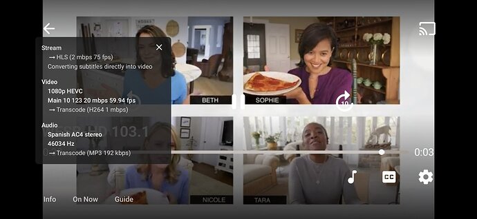

I have the same problem. I enable the channels and try to save the configuration and it does not save. I would like to be able to record the ATSC3 channels and decode the audio offline.

Did Plex just stop supporting ATSC 3.0 entirely? I used to get the channels without sound, but now they won’t tune in at all (on Plex, fine using HDHR app).
Depending on your market and the broadcasters themselves, you might be experiencing DRM on those channels, which I’m not certain if Plex is ready to decrypt them yet, Have you tried using the HDHomeRun app to double check what channels are affected?
