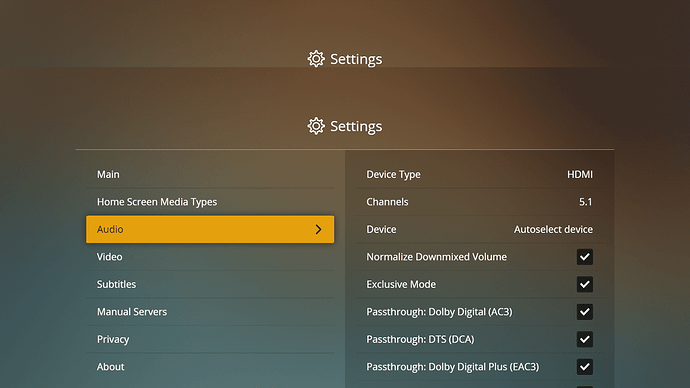

Please post a screenshot of your audio settings in PMP.
Hi Otto,
Thanks for the tip, but I already have all this checked. I’m replying from a mobile device now so I can’t post that screenshot right now. You just have to trust me. :slight_smile:
Could you look at the log file for the indicated timestamp and tell me what you think?

And here is the screenshot:
Nope. I just did a complete fresh install of the applicable drivers, but no change.
