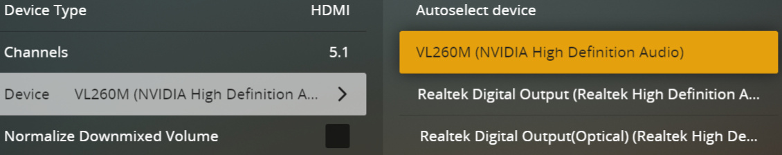

  2. When Device Type = HDMI, what are your choices for Channels and Device in PMP settings?
Suggest setting Channels to 5.1. Device will depend on your PC hardware/software.
On my PC is shows the NVIDIA graphics card and Realtek optical outputs (on motherboard). I choose the NVIDIA graphics card, since I’m using that HDMI port to pass audio & video to the attached TV. Pic below.
