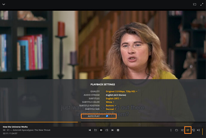

If you can get to the player OSD in time - see what the state is of Auto-Play in the OSD.
I do recall having to click that off - I wonder if it says it’s off, but it’s lying…lol

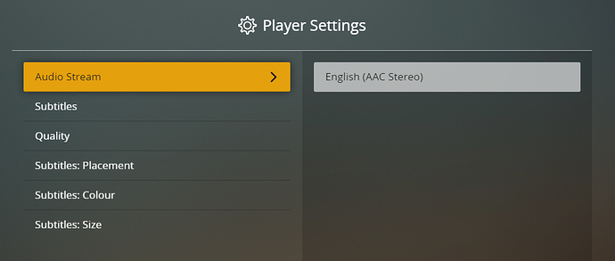

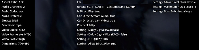

Where do I find this? If I press the letter i on my keyboard, that brings up loads of info but nothing that shows Auto Play state…
Or if I select this on the tool bar…
I get this…
While the item is playing - hit the Settings Icon.
I just found mine on - again - so I turned it back off.
You will find this on Plexweb/PMP/PfW - probably not on Android Mobile.

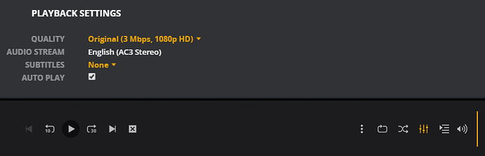

So it now turns out that specific interface is only present in PMP when in Desktop mode, and not in TV mode, and indeed doesn’t exist on Android Mobile.
Desktop Mode:
TV Mode:
And of course, when I untick the Auto Play tick box in Desktop mode, it is unfortunately still ignored for any episode under 5 minutes long.

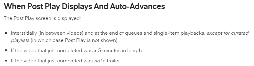

Some first feedback. It appears what we experience is actually in line with the current design… so it’s not so much a bug.
That being said… doesn’t need to mean the design is right and there shouldn’t be an option to reconsider it for this specific use case.
Well found Tom, and I agree that although this is by design, I’m not sure it was fully thought through…
I have found that when playing TV specials for example, when the last 2 specials are both under 5 minutes, it then “Auto-Advances” onto S01E01 when you are currently up to date on the regular seasons.
I think there should be a consideration when playing TV series, or at the very least, adhere to the Auto Play option being disabled within the client.

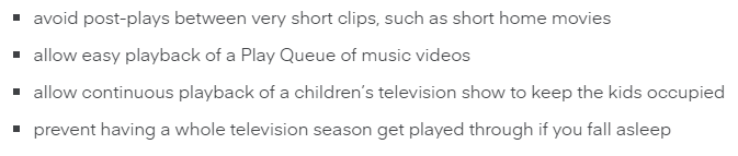

These are their considerations, and I certainly do understand them…

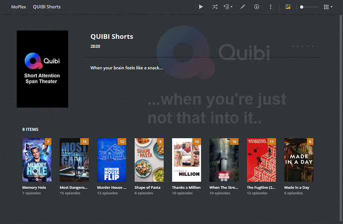

Yes, I predict to hear more about this:
I’ve got a half dozen headed this way at high speed from:
(Juicetown Artwork - is Public Domain - Enjoy)

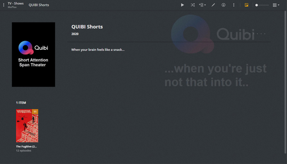

This Collection is in a growth trend:
I’m not gonna be happy about that lack of ‘Options’… that much is certain…
Oh we’ve opened a can of worms here! :wink:
Worms turned to Snakes:
