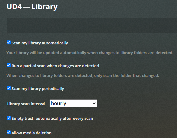

I made the mistake of upgrading the Server from v. 1.14.1.5488 to v. 1.19.5.3112. After the update, the Automatic Library Scan keeps Hanging.
If I cancel the scan and do a manual scan, it works fine.
Here are my settings:
Any idea on how to troubleshot this? I tried to look in the logs, but I have no idea what to look for.
Note that I didn’t have this issue before the Server update, and my library has not changed.
