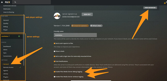

So, do I change it to Debug from the dropdown on the Console page? Or somewhere else? I’ve done that at this point.
Then what next? Just wait for it to happen again, then save the logs and re-post them?
Thanks again!
In the General settings of your server there is a check box for Debug and a check box for Verbose https://support.plex.tv/articles/200289496-general/#toc-1
Yes, If you cannot invoke it by adding any file and initiating a scan.
Thanks. FYI that that content in that link has changed. It isn’t on the Advanced view of the General page anymore. But I found a “Debug” page with a “Debug Level” dropdown on it with choices of “Disabled”, “Enabled” and “Verbose”. Oddly, it was set to “Disabled”, so not sure why the logs have been showing Verbose. Anyway, I set it to “Enabled”, saved, will keep an eye on it and if/when it hangs again, will post to this thread.
No it hasn’t changed. You are on the web app player settings not the server settings.
Ah, gotcha! I’ve unchecked Verbose and left Debug checked. And turned it back off on the web app player. Thx…

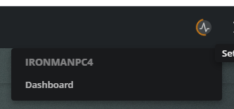

It’s hanging right now. Usually the status doesn’t show anything happening when I have to Cancel Scan. But right now, it IS spinning, and shows it stuck on this below. This is different behavior, so not 100% sure this is the same issue. Aside: That movie has been in there for a long time from back before this issue started.
