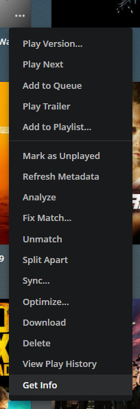

So, I know this is a dead thread, but just in case people looking to do something similar to what OP was hoping for, there is a less than perfect way to accomplish this goal, and it’s not entirely automatic, but it’s pretty effective. Basically you sort your library by duplicates, as the 3D version of your media will most likely be merged with the standard item, then split apart the duplicated files and rename the 3D version “Movie: 3D” or whatever your want.
If you’re not sure how to do this:
- Sort your library by duplicates
Doing this, if your 3D versions are intermixed and merged with your regular media, will list which items in your library have multiple versions of itself. 3D versions should already be merged with the standard versions.
- Click “…” in the lower-right corner of the media artwork, then select “Get Info”
Hopefully you’ve named your file something like “Media Name 3D” or some such thing.
If so…
- From that same “…” menu, select “Split Apart”
Now you should have 2 media items that look identical.
- Using the same “Get Info” option, verify which of the two is the 3D version, then rename it to set it apart from the original version. You can also adjust the poster to further differentiate the 3D version with the original:
