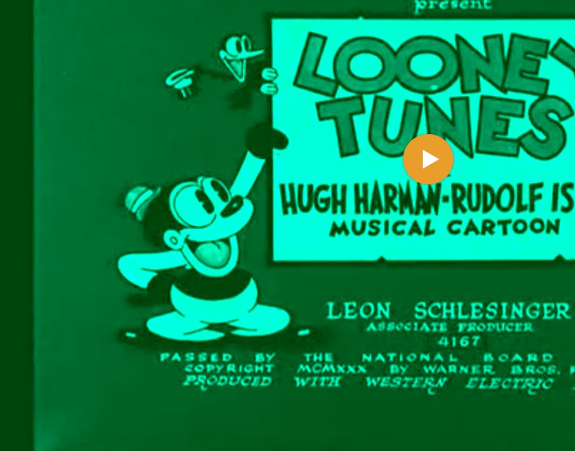

When playing video encoded as grayscale / black & white AVI, it displays as green or yellow, and too brightly, on my ROKU 3, and on my Plex Media Server on Linux (Ubuntu 22.04 w/AMD graphics)
If I use VLC to play the same content, it correctly displays as grayscale and at the correct brightness level.
This is what it looks like in Plex.
Screenshot_20230728_235851

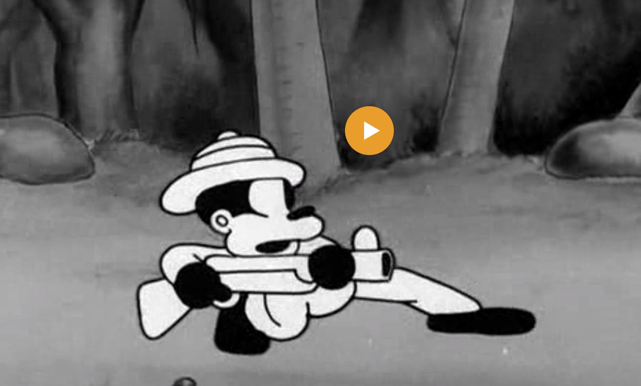

This is what it looks like in VLC and TOTEM

Please observe:
  1. No forced transcode on everything
  2. When forcing transcode, B&W is preserved.
Screenshot from 2023-07-30 13-17-15
