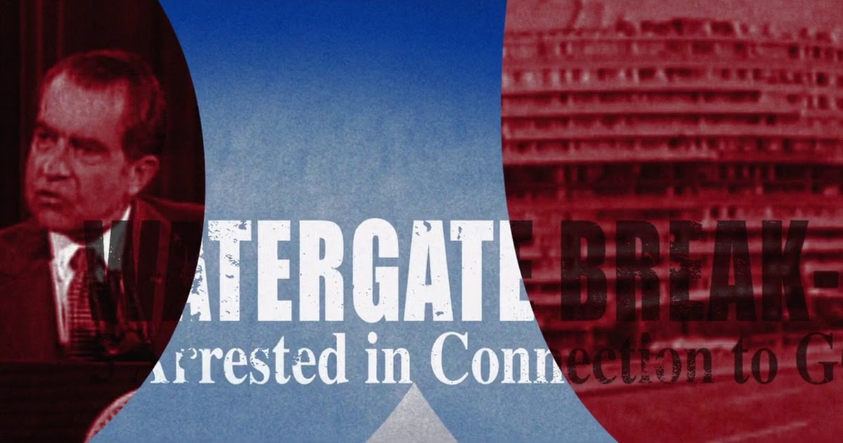

HW Transcode, Docker/Linux/Nvidia P2000 - Negitave Colors
Server Version#:1.18.3.2129
Player Version#: 4.16.4
Transcode Log File: https://pastebin.com/ZvRpQ2fb
Sample of Transcode Image: https://imgur.com/a/hp1bqeW
Looking for anyone who can help. Running into an issue that I’m a bit stumped on, some video files (haven’t nailed down which ones specifically) direct play fine, however if they are transcoded they get a green tint to them. Guessing this is some known issue specific to support of a codec or HW transcode on linux…hoping there’s a workaround.
Most transcodes are fine, seems to be higher quality videos are the issues…guessing due to the colors supported in the file.
System is a new build running ubuntu 19.10 with a Nvidia Quadro P2000.
NVIDIA-SMI 440.36 Driver Version: 440.36 CUDA Version: 10.2

what is the XML of the video played?
The logs show it plays along fine for a bit then goes into error state. Is there video file damage?
This one works perfect : https://pastebin.com/7AhGAveb
This one has the green tint: https://pastebin.com/gWr2WSNu
Some of the jumping around may be because I was playing different files that cause an issue and then playing files that work fine. As far as I can tell the files are perfectly fine as if I direct play them they work great…when I transcode them is when I get the odd green tint…however other than the green tint…they seem great…transcoded that is. Again, direct played they are fine.
Is it possible to get a sample of the file?
When I see solid green overcast on an image, the usual root cause is codec or video failure. A sample will allow me to replicate and then use to submit a trouble report
A dd slice, about 20-30 MB should do fine.
