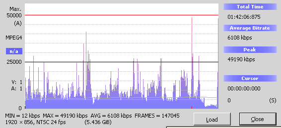

  • Does Plex need more Mbit/s then the bitrate for the movie? (Example, 4Mbit movie needs 6Mbit total)
Definitely yes. The Mbps we display in video metadata and in the settings dialog are average bitrates. A file may have a low overall bitrate but has some much higher bitrate scenes. This a view of my Frozen movie seen through the Bitrate Viewer. Notice the average bitrate of only ~6ish but several huge spikes:
