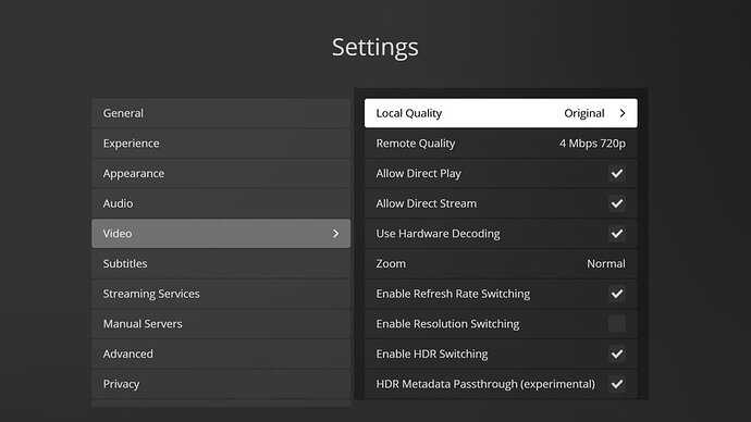

Have you tried to adjust the remote quality settings on the Apple TV?
The default is in many cases set too low
I don’t have an Apple TV so I’m not sure what it looks like for you, but this is from my HTPC
Yep, tried that. No luck unfortunately
