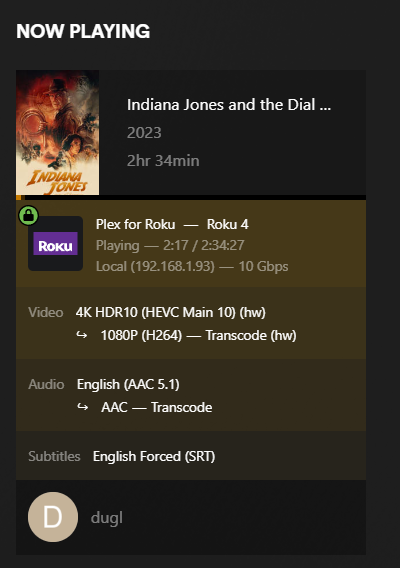

BUG #1: Hardware transcoding is not being used even though the dashboard has “hw” symbol. When looking at transcoder process -hwaccel: 0
[BUG #2]: Transcode bandwidth is insane, quickly saturates 100 Megabit ethernet port on the streaming devices.

On what are you basing your statement that hardware accelerated transcoding is not being utilized in this case? The FFMPEG command-line option -hwaccel:0 in this case means that it is to operate on stream zero, not that it is disabled. It would be better to install the “intel-gpu-tools” package (on Ubuntu, at least, other distributions may name it differently). Then intel_gpu_top will show you your iGPU’s utilization for various functions.
Oh, thanks for clarification. I thought that meant its not being used. (actually was googling documentation on this when you replied).

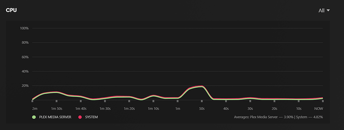

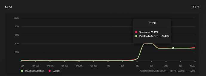

The reason I even started investigating this is because my CPU usage goes through the roof:
using multiple cores with often maxing out 1 of them to 100%. While (as seen below) other content where hw acceleration seems to work correctly it uses like 3% of a single core.
as opposed to for example another movie that also transcodes:

Regarding the specific examples you provided, I’m not sure they’re apples-to-apples. One is a 4K HEVC stream being transcoded to 1080P H.264; the other is a 1080P HEVC stream being transcoded to SD H.264. They may seem similar, but the bitrates are likely vastly different (hard to tell since PMS is miscalculating the bandwidth for your first example). But the media info details suggest it’s around 10 Mbps.
But you’re also burning subtitles in that first example (PGS) but not in the second. That 20% bump in processor utilization is likely normal in that scenario. Try the first example again without subtitles maybe.

Ok… maybe there is a problem. Without subtitles it does not use HW to transcode, uses CPU:
its same exact content I showed above with subs:
That is weird. You didn’t turn on HDR tone mapping, did you?
It is turned on. Is that a CPU only function? The page doesnt say…
just says this: Additional driver components may be needed to support hardware transcoding with this feature enabled; see our support articles for further details.
EDIT: Yup tone mapping off its using HW.
