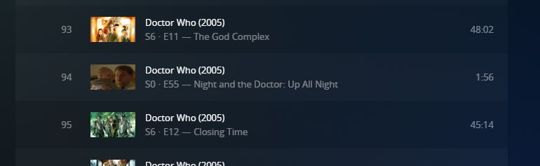

Doctor Who has short specials scattered between the seasons and episodes. I chose to play item 94 on the playlist (Season 0 Episode 55) because it was only a couple minutes long and would help expedite testing. Item 95 (Season 6 Episode 12) should play next.

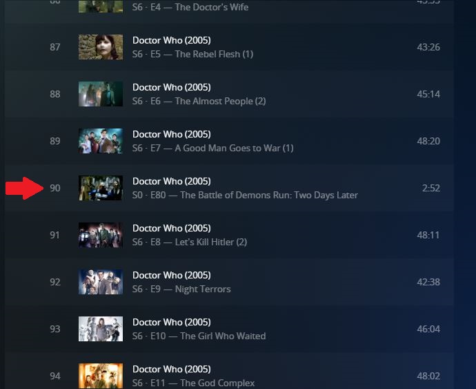

Description of events:
  1. Started playlist item 90.
  2. Item 90 played and finished without problems.
  3. PLEX crashed without playing item 91 (spinning circle, black screen, then PLEX logo). Event occurs around time stamp 04-08 18:54 in the player log
  4. PLEX rebooted to the Home screen.
  5. Activated Network Logging and generated client and server logs.
Playlist screenshot:
2022-04-08 0857

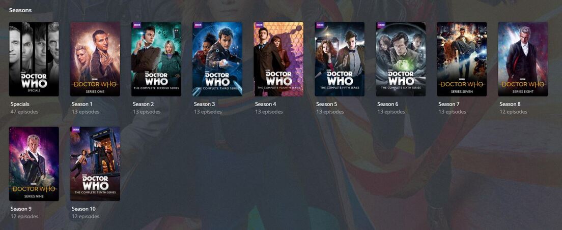

Details for today’s test:
The Doctor Who series has a number of specials (Christmas Specials, mini episodes, etc.) that occur between the regular season episodes.
I built my Doctor Who playlist based on this article’s watch order:
Here is a screenshot of the playlist for this test’s episodes:
For today’s test I chose to start item 64 on the playlist. This should result in the following play order:
S00E67 → S05E02
I tested this out on the following devices:
Windows Laptop running Plex for Windows Version 1.44.0.2981-e2d72ac2
iPad Pro runing Plex Version 8.2
NVidia Shield TV Pro running Client Version 9.2.0.32419 beta
Playlists worked as expected on the Windows Laptop and iPad Pro clients but failed to play the correct next episode on the NVidia Shield TV Pro. Instead, the Shield played the next episode in the Specials season folder (S00E67 → S00E68).
So in this test, the Shield did not crash after the first episode but chose to ignore the playlist order and chose to play the next episode in season.
