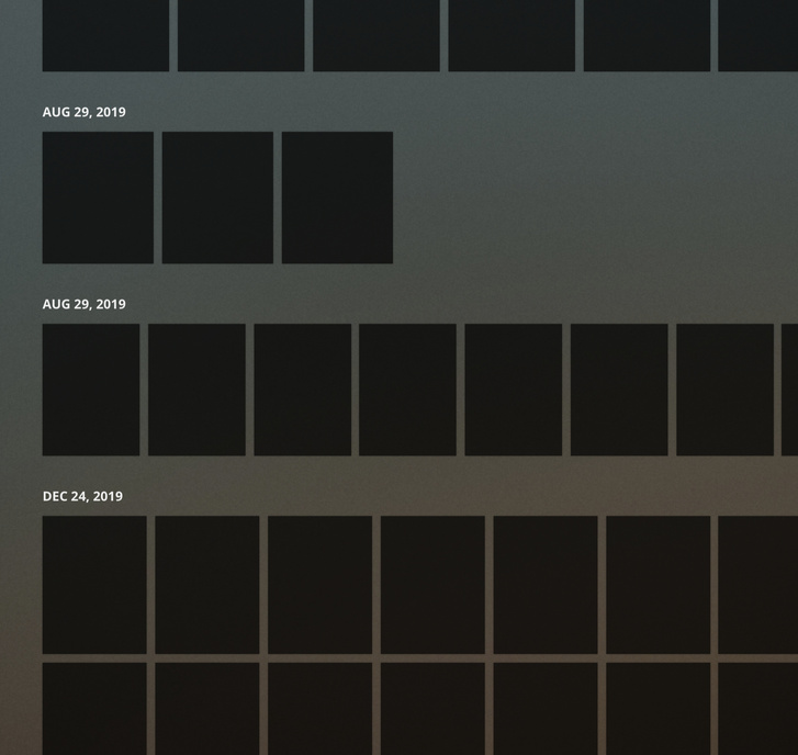

@mm98 can you share what seemed to have solved your issue? I’m experiencing similar problems where photos uploaded with correct metadata is showing up incorrectly in the timeline view. See attached.
Note the Dec 24th photos are accurately grouped, but showing up “later” than where it should be in the timeline view, earlier than August 29th
