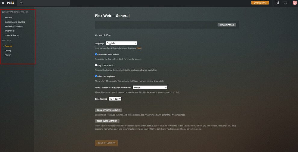

OK. I have done exactly as you instructed. Once the web page opens after step 6 I am immediately greeted by the No Soup garbage. I then sign in and attempt to access the Server settings you point me to but there is no such thing on my screen. No server section listed.

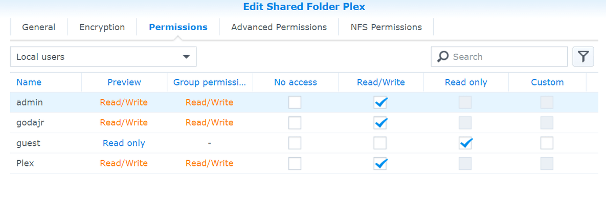

Would you please do the following so we can see what your server is seeing?
On the Synology DSM window (where you control the NAS)
Control Panel - Shared Folders - Highlight the Plex share - EDIT tab.
Now click the Permissions tab.
You will see your name listed there on the left side.
Make sure you have (click the box if needed) R/W (read/write) permission.
Click OK

No server settings present.
