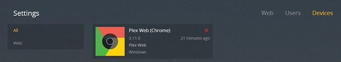

I have installed plex server on synology, but i cannot see servers option in web.
I log into plex server using local ip. Undser settings i have “web, users, devices”. On home page i have “Looking for server… A server could not be found. Download and install Plex Media Server, and it will appear here.”
Device synology ds414. Plex version 1.3.3.3148-b38628e
What could be wrong. I can access my device from http://externalip:32400/web

Im using windows pc with chrome to access plex
https://dl.dropboxusercontent.com/u/74801088/Capture.PNG
https://dl.dropboxusercontent.com/u/74801088/Capture2.PNG
Indrek
I dont have settings-> server option. I only have web, users, devices.
It feels like NAS is not acting as Plex server.
