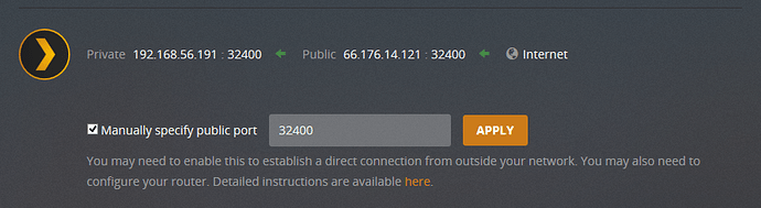

Strange issue my plex says its Fully accessible outside my network and my friends can access it remotely. But when I try to access my server from inside my home network using my public Ip its doesn’t work. If I use my internal IP it works. I see in the log Alexa it is trying to hit my external IP instead of my internal ip
I did some further research and see this is called NAT hairpinning" and “NAT reflection” and most routers dont support it. Since Alexa is being given my external ip and my router doesnt do the hairpin the stream dies at the router and Alexa get nothing but silence
Any chance you guys could DNS to my internal Ip. You must be doing the DNS at 66-176-14-121.2d338be7167f4e4291e3bd2f9bfc51e9.plex.direct:32400. 66-176-14-121 is my external ip and that entry is at plex.direct which I assume you guys hande.
I think this is proably anissue for a lot of people that have routers like mine
Here is a snapshot of my plex
remote settings

so… it is still working for me today with the following setup:
Goto Plex Server settings, Remote Access. Check manually specify public port and set it to an unused port.
Goto my router settings and map that public port to my Plex Server (which has a static ip and port 32400).
What I did notice is that if I didn’t manually specify the public port in Plex… it has a tendency to change.
It’s working fine… and this was the only change I made to my setup to keep it working consistently. I’d hope that this info will help Plex nail down the overall issue… as I would think that it should not be required to work by having these physical settings required.

I have set up port forwarding and have manually assigned a port
https://app.plex.tv/desktop - works both inside and outside my home
https://FQDN:32400 - only works outside my home network
http://192.168.1.191:32400 works inside my home network just fine
No matter what I do Alexa Announces the song and then I get silence
only difference you are exposing 32400 externally… I used a different external port number 13868 (plex default for internal stayed at 32400). Not sure how all this Alexa stuff works… but you might want to try the port number change and associated routing and see if that gives you anything.
