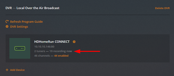

On the site I’ve seen it written on forums and Plex’s own product pages that devices with two tuners, like the HD Homerun series tuners, can be used to either watch two shows, record two shows, or watch and record one show each, at the same time. Has anyone actually tested and tried this. I’ve been trying to get this to work for myself, but when I make recordings that double book the same time slot the recording schedule interface throws an error at me asking me to modify the schedule, and then only one show gets recorded. Even right now. I can see two shows are scheduled and only one tuner is being used (see picture below of HD Homerune Connect Web Interface.) I’ve tested watching two shows at once on a phone and desktop earlier, and that worked fine, but then I nearly flipped a ■■■■ while trying to record a show while I was watching TV. Plex didn’t start the recording on time. I paused to the show I was on to see why. Couldn’t find a good reason. I killed my current channel, and THEN I got a notification that recording had started. I thought, well what the hell, what happens when I try to watch TV. Now while Plex is still recording I get this damn error about playback one EVERY channel (see second photo below.)
Does someone know what I did wrong, or have any workaround to make this DVR / Live TV function not totally suck?

I can see both of my tuners. It just doesn’t seem to use them. In my original post, you can see it seems to only use tuner 0, as shown by the web interface of my HD Homerun Connect. A playback error is given when I try to watch TV while it is recording
So aparently, the TV Tuner interface is useless. I have a show recording right now, and it shows that nothing is being used.
Show is recording according to Plex. Also, I still see conflicts with the recording schedule. Is this just a generic warning? I still only record one show at once, but is this normal for everyone else?
First off you show you have 2 tuners with 10 recording now which is not good.
Can you get plex restarted so it shows 2 tuners and 0 recording?
All those shows with a red circle and hung recordings in your system.
Lets get that cleared out and we can try again.

I’ll give that a shot thank you. I was actually pissed a second ago. I saw none of the shows for today that were scheduled actually recorded, but Plex said they recorded 100% complete. The wife is watching her shows right now, so I can’t reboot it just yet, but I’ll reboot it tonight and see if I can get it to act more normal.
Thanks for trying to help man.
I just rebooted my server and OMG! So many recordings! I’m going to try deleting the DVR and recreating it.

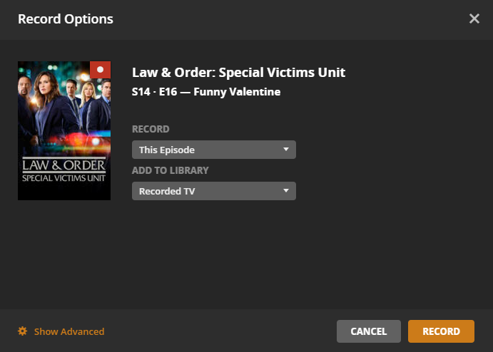

What makes it all the more ■■■■■■■ aggravating is Plex keeps telling me it recorded the TV show:
I checked it’s trying to save to the right library and it has write access to that location. That was proven with another show. There aren’t even any recording conflicts:

I’ve noticed the only shows that recorded successfully finish with a play button next to them. Does anyone know of why Plex would use the recording symbol for the failed ones?
Well this is even more damn annoying! I went to go modify the recording settings of a show that is supposed to be recording, and the damn thing doesn’t have any of the original settings I put in there, despite the recording schedule saying it’s being recorded:
