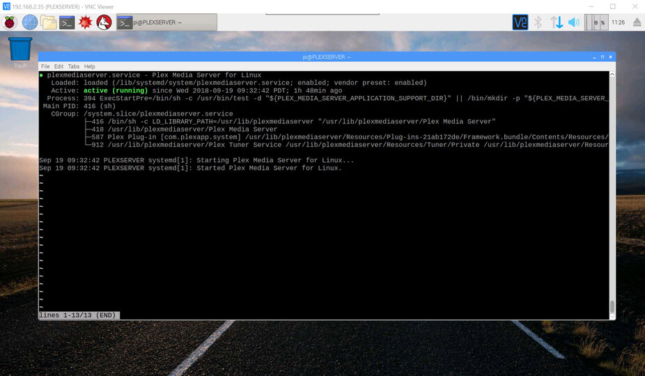

So, pleas take a look at the owner of the files, at the Linux user PMS is using and at the Linux user you have used for Samba.
We need the output of ls -ahl /my/media/directory and systemctl status plexmediaserver.
PMS updates do not change permissions of any file. Only the PMS user might have changed. PMS cannot change your Samba config. So some other update broke your setup. Not Plex. So let’s find the culprit.

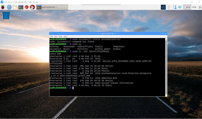

Hopefully this screenshot will shed some light on what’s going on. I tried to do a ‘systemctl’ but Debian didn’t recognize it
Small typo in your command: it is systemctl, not systemsctl.
The directory listing is OK. drwxrwxrwx tells use owner, group and everybody else can do everything with the directories. The owner and group is root. Please also take a look at the permissions of the individual files and compare the first column or post the complete output for a single file you are unable to remove in PMS.
Unfortunately the terminal isn’t wrapping lines so I can’t see what’s off screen

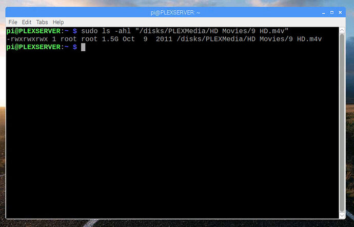

That’s OK. I just needed to make sure you have the default configuration. PMS runs as Linux user plex on your device. That’s perfect. Now, please check the permissions of an individual file, e.g. with ls -ahl "/disks/PLEXMedia/HD Movies/moviename.mkv". The double quotes are important.
Here’s the first file in that folder.

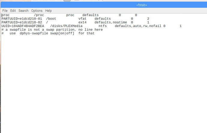

Please post your /etc/fstab file. Either there is an issue there or the file system of your drives has errors and requires repair.

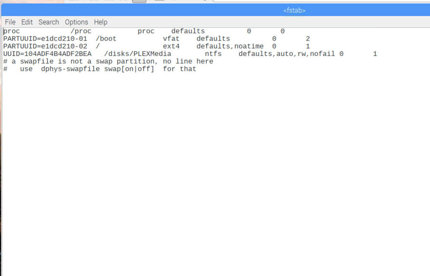

Here’s the
fstab
Everything is correct there. Please attach the drive to your windows pc. I am quite sure Windows will try to repair the disk.

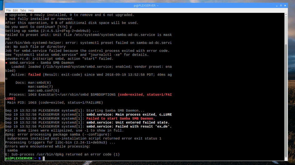

I decided to try purging Samba and then reinstalling but now the Samba service refuses to start and the Samba folder is empty
