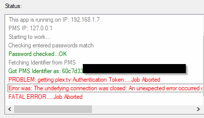

Here is the error I get with ClaimIt 1.1.0.0 running on the PC that is running PMS
I tried both 127.0.0.1 and the IP for the server and both return the same error.

Please try the version mentioned in this issue, and also please report back, so I know if it’s working or not:
I tried the version mentioned in that post. I got a different error this time.
Error2
I took a look at the steps for Error 500 on github and this is a clean install, no changes have been made to the preferences.xml file. I tried the ping test and there were no issues there. My DNS on the router and PC are both set as 8.8.8.8 / 8.8.4.4.
