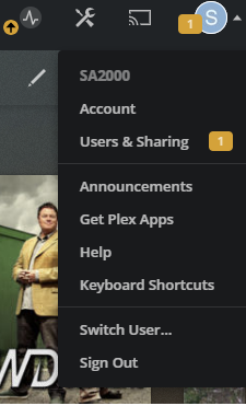

If you are using Plex Web, you should be able to sign out from Plex Web and sign in again - after claim and then restarting the server, look for the Plex Web account sign out

This is the place where you sign out Plex Web session - top right corner in browser
