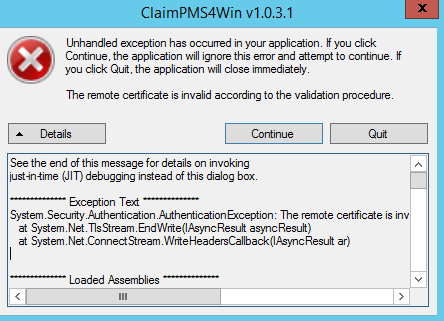

Use the tool from Method 1 in here: You need to reclaim your server, but don't dare to touch the Windows Registry
Then post the log messages from the left side if it still fails.
Is the date and time set correctly on your server machine?
Are you running a 3rd-party anti virus or firewall software?
the time and date are correct. And which URL is being accessed and which ip address should correspond to it. Yesterday there was a strange situation when the plex website.the tv did not open, because an incorrect certificate was pulled up

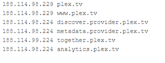

The provider has some problems with DNS. After I manually registered all the addresses of all the services, everything worked.
You might as well switch from your ISP’s DNS server to the public one from Google. 8.8.8.8
Is probably easier and will continue to work if those IPs change eventually.
