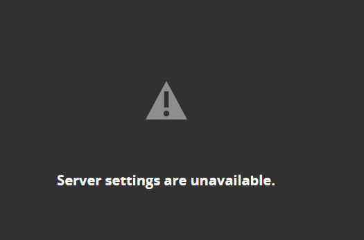

However even after a Server restart even though i can now access my media i cannot change the server settings:
So after some Fiddling it seems i had to change to D: and start plex. Change the plex path to X:. restart the pc. restart the pc (plex was no longer working) change the Drive letter to X:. Restart the system again and then Finally it connected. Sorry for the Inconvenience.
