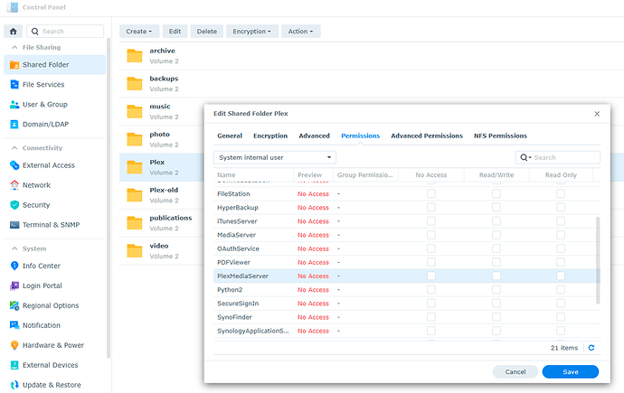

Now please verify you have ‘Custom’ in the Plex share,
And can give “PlexMediaServer” Full Control (Custom) ACL permissions.

  1. Control Panel
  2. Shared Folders
  3. Rename the Plex share to be Plex-old
  4. Create a new shared folder named Plex
  5. Add the permissions for yourself, administrator, and, while you are there System Internal User PlexMediaServer (who gets Custom - Full Control … the Administrative, Read, and write checkboxes)
  6. Save that and exit
  7. Come back into Shared Folders
  8. EDIT the new Plex share
  9. Verify PlexMediaServer still has “Custom” permissions.
