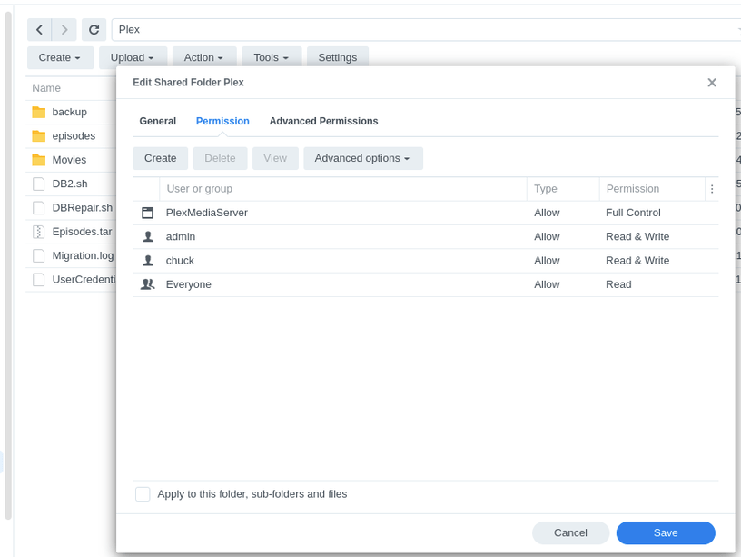

  1. User PlexMediaServer isn’t a regular user. You won’t see it listed under Users
  2. Since you didn’t get any Permission warnings / errors when installing, something probably modified the permissions of your “Plex” shared folder manually and broke it for the upgrade
Here’s the quick How-To to get working
  1. Confirm your “Plex” shared folder still has “Library/Application Support/Plex Media Server”.
  2. STOP HERE if it does not.
Continuing
  1. Uninstall PMS with the ERASE option (the empty DSM 7 must be removed)
  2. Follow this very carefully. Some steps might not apply but 99% will apply
    – Do not skip any of the “Apply to this folder, sub-folders. and files” checkboxes

If the installer did not detect and automatically start the upgrade (which does not require admin privilege) then there is one of a few things:
  1. Permissions on the shared folder are still not correct so it can be seen.
  2. Plex/Library/Application Support/Plex Media Server/Preferences.xml does not exist.
Can you confirm PlexMediaServer has Full Control of the Plex shared folder ?

  1. Give System Internal User PlexMediaServer Full Control (All Administrative, Read, and Write) permissions to the Plex shared folder
    – ALSO, ensure to "Apply to this folder, sub-folders, and files.
  2. Full control is required because:
    – PlexMediaServer., nor the installer. are privileged in DSM 7 (Synology change)
    – You must grant the new username ‘PlexMediaServer’ full control so it can do what it needs to (Synology’s new security)
    – During the migration from the Plex shared folder to PlexMediaserver, it will
    Change owning username
    Convert all old data structures (absolute paths to relative paths)
    Move to agnostic volume path (not hard coded / tied to any volume)
    – Lastly, it’ll move all the Plex files from “Plex” → “PlexMediaServer”
  3. When it’s done, the only thing left in “Plex” will be any media / other files you might have there.

Please read all of this before proceeding. This will remove the new instance of Plex Media Server, then restore your old server.
Step 1: Login to the NAS. User must have admin rights.
Step 2: Control Panel → Security.
  • Set the logout timer to a large value such as 3600. You can change it back when finished.
Step 3: Give user PlexMediaServer full control of the Plex shared folder.
  • Control Panel → Shared Folder. Select the Plex shared folder and Edit.
  • On the Permissions tab, change Local User to System Internal User.
  • For user PlexMediaServer, select Custom. Select all boxes - Admin/Read/Write. Click Done.
  • IMPORTANT: You will be back at the Permissions window. In the lower right corner, check the box to “Apply to this folder, sub-folders, and files,” then Save.
Step 4: Give user PlexMediaServer permission to access your media files. Repeat step three for the shared folders holding your media. Give either read-only or read-write access. Admin rights are not needed.
Note: Read only is sufficient for Plex Media Server. Read-write is needed if you are recording using LiveTV/DVR, creating optimized copies, etc.
Step 5: Completely remove the new server from your system.
  • Launch Package Center and uninstall Plex Media Server.
  • When prompted, choose “Erase all of Plex Media Server from this system (Not Recoverable).” This removes the new server from your system.
  • When the uninstall finishes, use File Station and look in the PlexMediaServer shared folder. If there are any files there, delete them. The folder must be empty.
Step 6: Re-install Plex and start the migration.
  • Re-install Plex Media Server. When prompted, choose a “Normal” not Claim Token installation. It is OK to use the version in Package Center (you can upgrade later if desired).
  • This will start the migration. The installer will move the files from the Plex shared folder to the correct location in PlexMediaServer.
  • The installation will take some time. A rough estimate is 1 minute for every 1000 media files on the server (movies/shows/etc).
  • If possible, do not logout. It won’t hurt anything, the migration will continue, but you will not be able to see the progress. This is the reason for increasing the logout timer earlier.
Step 7: When complete, claim the server.
  • When the process completes, the Plex shared folder should be empty except for a migration.log file.
  • From a system on the same network, login using the IP address of the NAS. For example, if the IP address of the NAS is 10.1.2.3, use http://10.1.2.3:32400/web.
  • Do not use app.plex.tv, a domain name, click the Open button in Package Center, etc. Those methods cannot be used for claiming. Once claimed, then they’re OK.
  • Once claimed, you should see your libraries, etc.
