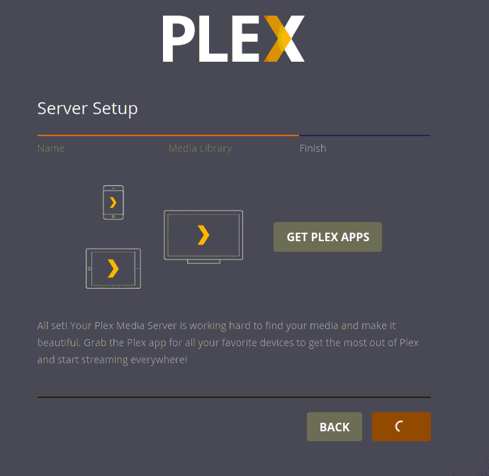

I was having some trouble with a previously installed instance of Plex Media server, so I decided to completely remove it and reinstall it.
I ran the following commands:
sudo dnf remove plexmediaserver
sudo rm -Rf /var/lib/plexmediaserver
sudo userdel plex
I downloaded the latest RPM available for me: plexmediaserver-1.18.4.2171-ac2afe5f8.x86_64.rpm
Installed it using: rpm -i plexmediaserver-1.18.4.2171-ac2afe5f8.x86_64.rpm
It installed successfully, and the process started. I connected locally to the server on http://localhost:32400/web and skipped logging in to my Plex Pass account.
I setup a server name, add a single Movies library, and go to complete the setup, but at the last screen where it says “Finish” and “All Set! Your Plex Media Server is working hard to find your media…” the finish button just sits and spins.
I have left it for over an hour, I have tried setting the server up with no libraries at all… I cannot complete even a local setup of my Plex server.
Does anyone have any ideas that I can try?
I’ve tried removing the 1.18.4 server and rolling back to 1.18.3, but the same thing happens.
Thanks all!Plex Screenshot

The services starts, and I’m able to run through the preliminary setup, but I’m never able to access the local servers dashboard. Attempting to load the dashboard just results in an endless spinning circle.
