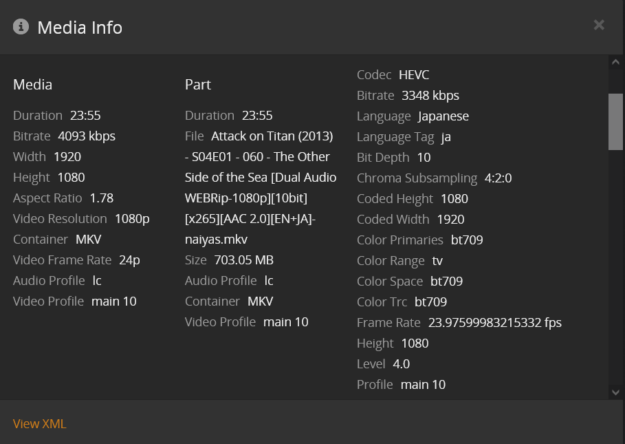

So my PMS is a Debian 11 box with a J5005 CPU and hw transcoding enabled. When I play anime through the Fire Stick 4K (and LG TV Plex apps), it can transcode a 1080p H.264 High 10 file (w/ ASS subs) just fine but when the file is an HEVC Main 10, playback just doesn’t start. Is there any reason why it can’t transcode a simple 1080p file?
Attached is the copy of the PMS log file that contains my attempts to play HEVC Main 10 files:
Plex Media Server.log (3.2 MB)
I can’t test it with my Shield currently because its PSU died but I’m assuming it also won’t play in the Shield as the problem is in the transcoding part in the server.
Attack on Titan - S3 E1 - Smoke Signal → 1080p H.264 High 10
Attack on Titan - S4 E1 - The Other Side of the Sea → 1080p HEVC Main 10

Spin that to H.264 8-bit or HEVC 10-bit and you’ll be fine but VAAPI isn’t going to allow what you have there (H.264 10 bit).
I don’t understand though. But I’m getting the issue when playing the HEVC Main 10 file, not H.264 Main 10. For example, this is the one that doesn’t play:
The logs you parsed above were from the working file (S03E01) which is an H264 High 10 file. What you’re saying is the opposite of what I’m experiencing. I can play (transcode) H264 10bit but not HEVC 10bit.
If you check the logs again, there is another one that shows the HEVC Main 10 file that the PMS cannot transcode:

The J5005 is a low-end CPU from the Gemini Lake architecture.
But is a relatively slow thing PassMark - Intel Pentium Silver J5005 @ 1.50GHz - Price performance comparison
This table Intel Quick Sync Video - Wikipedia
says it has support for HEVC 10 bit
I wonder if this is purely dependent on the subtitle format.
ASS can put a higher load on the server (because it supports quite complex formattings and even animations) than a pure SRT file.
Right, but this is just 1080p. I know that when it’s H.264, I can play it with the ASS subs just fine.
HEVC HDR takes approx 2-3x more CPU than does H264.
When burning subtitles, that means you need the faster per-core speed these CPUs do not have.
Is this true for HEVC non-HDR too (like the sample file I sent)?
So the root cause for this is the CPU itself?
Yes, to both.
we get HW decode,
we must then SW burn the subtitles on each frame.
we can then again HW encode.
we software process audio as usual.
If the single-core speed of the processor is not fast enough to keep up with real-time demands at the bit rate given then it’s going to stutter.
Ahh, I see. Why is HW transcoding not working for subtitles burning? Is this a limitation of some sort?
I understand that it would stutter but in my case playback doesn’t start at all. Shouldn’t it at least initiate the playback?
Recreate that for me please and attach the log?
It should start even if it takes time.
Because nobody has thought about it yet. Plex is using ffmpeg for it’s transcoder. There is no hardware support for burning-in subtitles in ffmpeg.
And it isn’t even known if hardware support is a thing in GPUs and CPUs at all.
All they do in hardware is “decoding” and “encoding”.
Nevermind. I tried and again and I just had to wait more (around 30 seconds +) for it to play and it started buffering. Do you think a G6400 or an i3-10100 will be able to transcode this kind of video with ASS subs?
I see. What is the reason why ASS subs need to be burned in while other subs like external SRT don’t?
Because most client types cannot read them.
