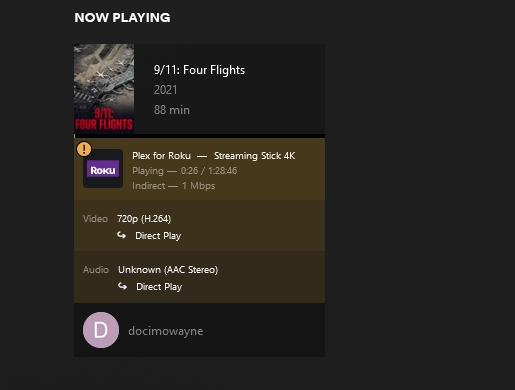

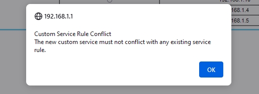

Here is where i am at. I turned my VPN off. I tried to change the port forward in my router and was given an error message (see pic). I had my brother log into my plex, initially the remote access was green then it turned red in a short time. Whether it was green or red, he now was getting direct play (see pic), with an indirect error message (also in pic). Im just happy he was finally getting a direct play (quality) without transcoding. Suggestions from this point? Contact my Provider about the port forwarding??? sounds like an issue there. Anything else? Thank you again everyone! :slight_smile:

Ah, very good to see we’re almost there. Can you show a screenshot of your router’s port forwarding interface without that error? Black out any information in there you feel might be sensitive information if you like. It sounds like you might have entered the wrong information in the wrong field. The error sounds like you have setup a port forwarding already for that particular port (32400) to a different computer. Routers can’t forward traffic to two different computers at once.
Your brother can view files direct-play, because it looks like your videos (720p) are small enough to fit within the Plex relay’s ~2 Mbps speed limit. Anything bigger or uncompressed will not fit, and will transcode.
It’s standard for the Plex server to show a “green, external is working” color, before changing to red a second later. I’m not sure why the Plex devs did it, but they have it give out false hope for a second before it ACTUALLY checks to see if external access works, which fails, and changes to red.
