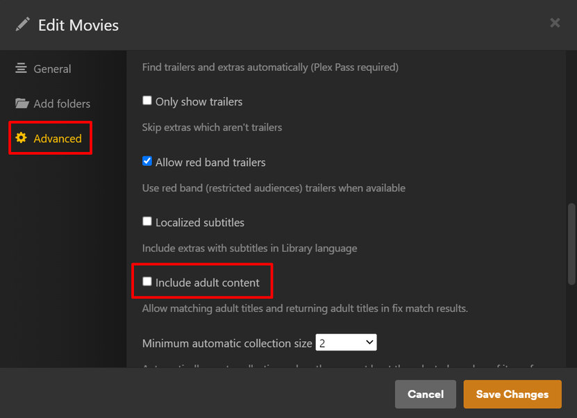

I have had the same problem with Discover Credits. I just figure out (by this thread), that you must have Include adult content disabled on each library. I then logged out and back in again and it worked.

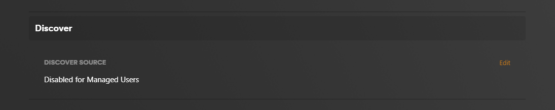

Make sure that you are using your admin Plex account for testing. Access to Discover is currently limited for managed users.
Go here https://app.plex.tv/desktop/#!/settings/online-media-sources
and make sure that “Discover Source” is not “Disabled”.

That only two option is “Disabled for managed users” and “Disabled”

Yes. But it means that your managed users won’t see it.
