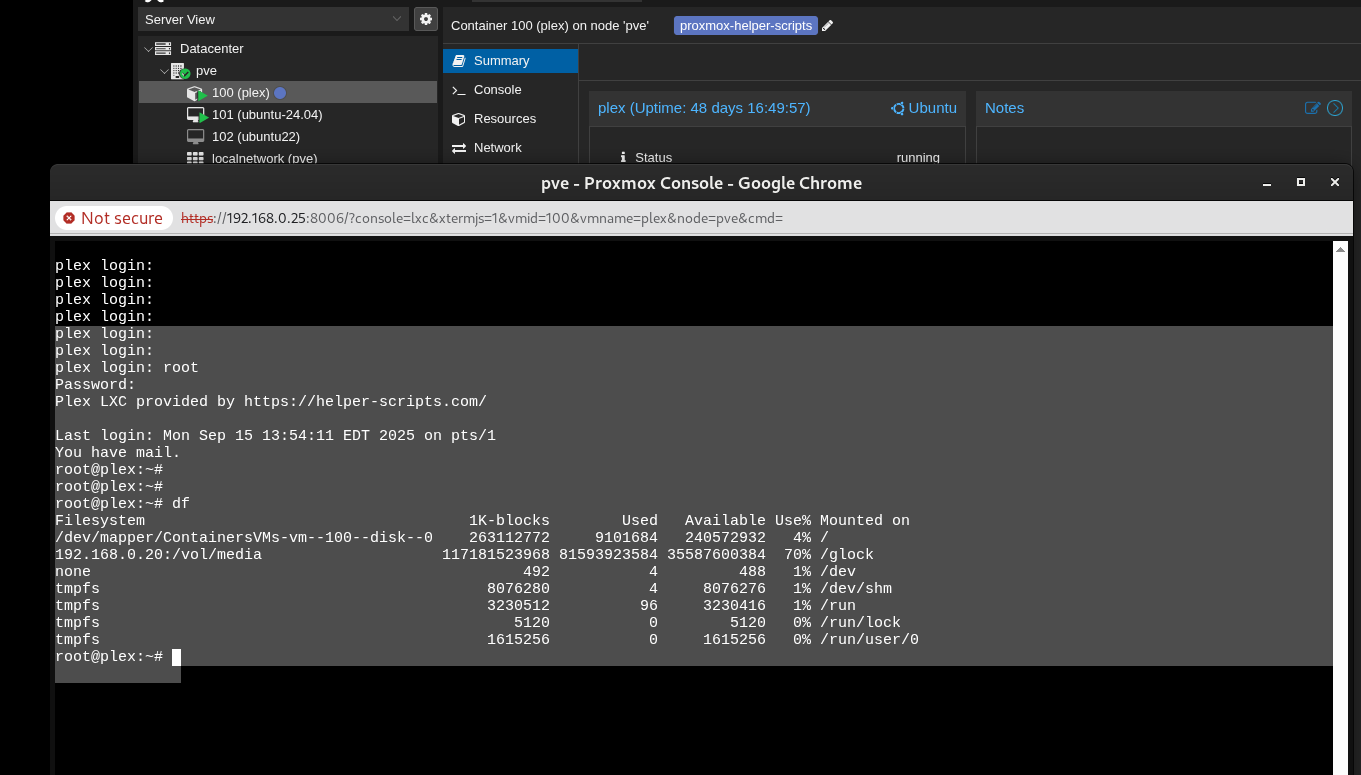

The easiest and best success I’ve had with Proxmox and iGPU is using the TTECK helper scripts.
It will setup the entire thing for you.
The hostname it creates is plex.
Create the mount point and then perform the mount for the media (if needed) in Proxmox.
Mine looks like this (glock is the NFS server with all the media)

Here is the container config I have
root@pve:~# pct config 100
arch: amd64
cores: 4
features: nesting=1
hostname: plex
memory: 8192
mp0: /glock,mp=/glock
net0: name=eth0,bridge=vmbr0,hwaddr=BC:24:11:64:46:69,ip=dhcp,type=veth
onboot: 1
ostype: ubuntu
rootfs: ContainersVMs:vm-100-disk-0,size=256G
swap: 512
tags: proxmox-helper-scripts
lxc.cgroup2.devices.allow: a
lxc.cap.drop:
lxc.cgroup2.devices.allow: c 188:* rwm
lxc.cgroup2.devices.allow: c 189:* rwm
lxc.mount.entry: /dev/serial/by-id  dev/serial/by-id  none bind,optional,create=dir
lxc.mount.entry: /dev/ttyUSB0       dev/ttyUSB0       none bind,optional,create=file
lxc.mount.entry: /dev/ttyUSB1       dev/ttyUSB1       none bind,optional,create=file
lxc.mount.entry: /dev/ttyACM0       dev/ttyACM0       none bind,optional,create=file
lxc.mount.entry: /dev/ttyACM1       dev/ttyACM1       none bind,optional,create=file
lxc.cgroup2.devices.allow: c 226:0 rwm
lxc.cgroup2.devices.allow: c 226:128 rwm
lxc.cgroup2.devices.allow: c 29:0 rwm
lxc.mount.entry: /dev/fb0 dev/fb0 none bind,optional,create=file
lxc.mount.entry: /dev/dri dev/dri none bind,optional,create=dir
lxc.mount.entry: /dev/dri/renderD128 dev/dri/renderD128 none bind,optional,create=file
root@pve:~#
