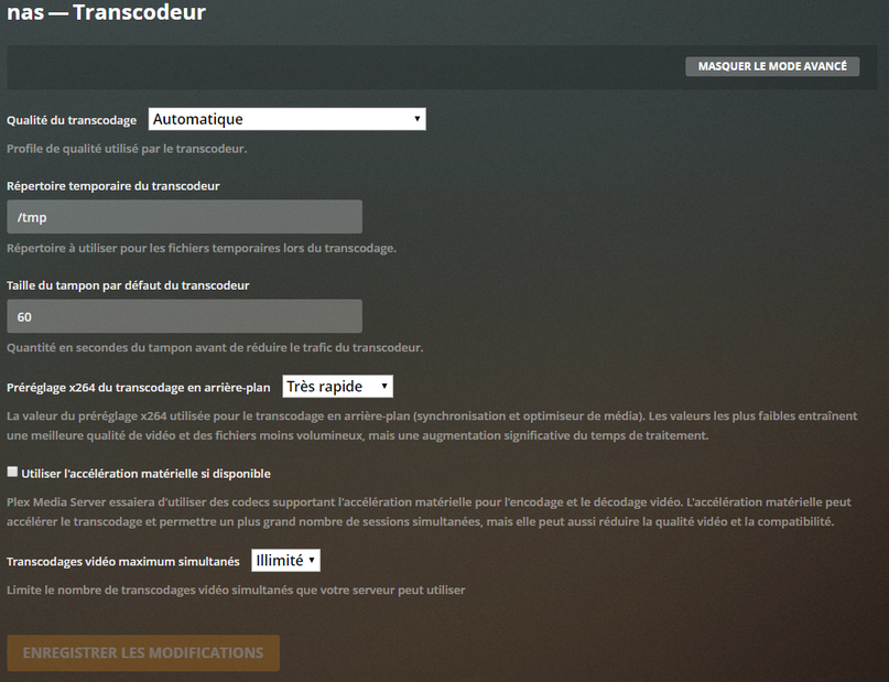

Could you please share a screenshot of your transcoder settings ?
Here are mine:

My transcoder settings are pretty close to yours.
The only difference is the checked option for hardware acceleration.
I don’t enable subtitles for live TV.
