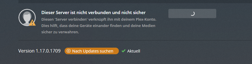

Hey guys. I just signed out on my computer and when trying to log back in it couldn’t find my server anymore.
It said the server needs to be assigned to my Plex account (Please see the following image)
But after clicking the notification and on “login” (server) just nothing happens and the circle keeps spinning forever (Image 2)
What I’ ve tried is to sign out (of all devices) to have a new Plex Online token generated and it did generate a new one, but the outcome is the same.
Could anybody help me with that? I would be desperate if my server was gone :frowning:
EDIT: Wheel still spinning :slightly_frowning_face:
Forget this post. May be deleted. I’ve tried for over an hour now and all of a sudden it worked without any further ado lmao. Holy Pleccaroni
