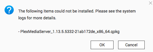

I’ve got a TS-451 running QTS 4.3.4.0765 (Build 20180810) and am unable to install the last several versions of PMS when it pulls up the orange banner to tell me to update. I download the latest via the link, and it pulls the QPKG from the Plex server. I go into AppCenter, try to install manually via the + button in the upper right corner, point it to the qpkg and hit install. As soon as I hit install, it tells me that it can’t be installed and to see the log why. It has nothing in the log. I also checked /var/log/message and there’s absolutely nothing in there either.
51%20PM
This has been happening for about a month, definitely the last couple of QTS firmware updates.
Previously, I have had success over the last year or two manually installing PMS whenever there has been an update.

I had the same issue and created a thread here: https://forums.plex.tv/t/unable-to-install-latest-server-package-on-qnap-nas-64-bit/294399/30.
The long and short is that I logged a ticket with QNAP who basically told me they did not support updating this way. Plex employee Chuck was exceptional in helping me out with a way to do it via the command line.
I would suggest raising a ticket with QNAP as the more of us that do this might mean that they acknowledge the issue and do something about it.

For all who are experiencing this issue,
Please PM me the QNAP trouble ticket number with a link back to this thread so I may coordinate between Engineering and QNAP.
Please also include the QNAP model and Firmware version.
As an INTERIM workaround while this is being investigated:
  1. Upload the PMS qpkg file to a share on the NAS.
  2. SSH into the NAS and cd to that directory.
  3. chmod +x the file
  4. ./filename.qpkg to execute it (it’s a self-contained installer in the QPKG)
