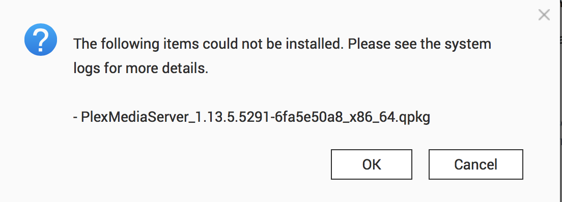

I have just tried to do an update of my Plex Server on a QNAP TVS-EC1080 running 4.3.4.0644.
When I try to do the usual manual install I get following error:
“The following items could not be installed. Please see the system logs for more details”.
The version I am trying to install is: PlexMediaServer_1.13.5.5291-6fa5e50a8_x86_64.qpkg

Gary,
That’s a new one indeed. What does the system’s log report?

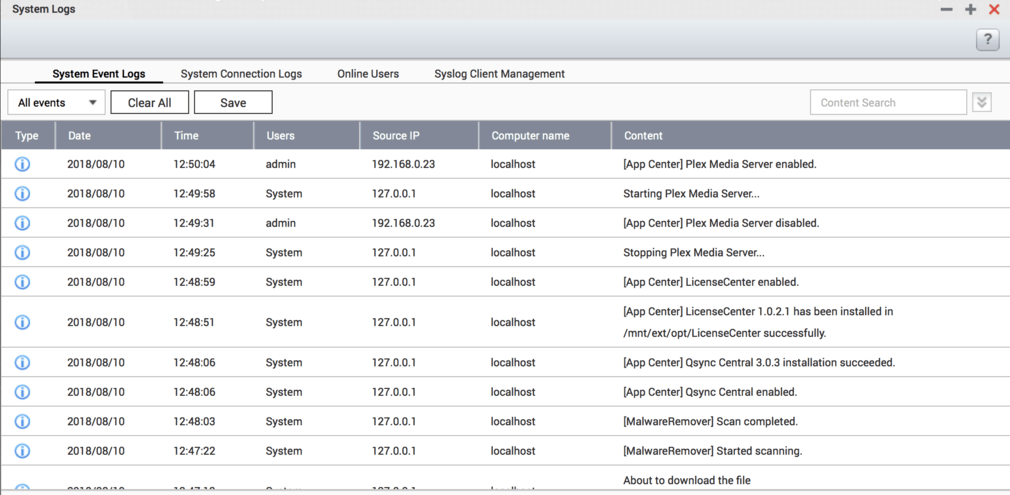

Chuck,
The GUI System Log shows absolutely nothing.
The error came between stopping and enabling Plex around 12:50.
I am not sure how else to view logs as I am not really a CLI guy.
Regards,
Gary.

My system is in the second screen grab I posted in my first post, albeit a bit small to view in one.
This is what I ask about.
