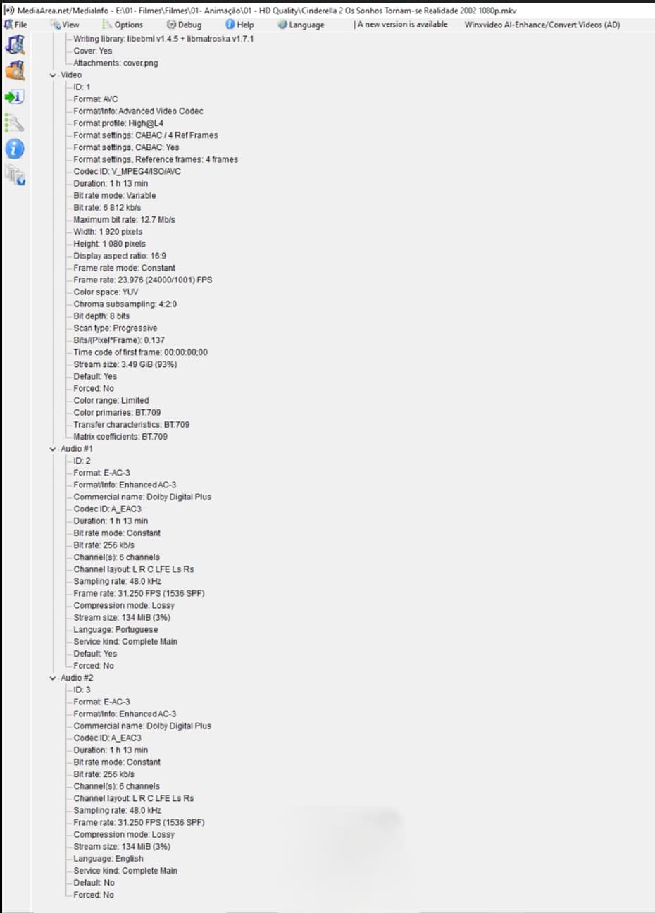

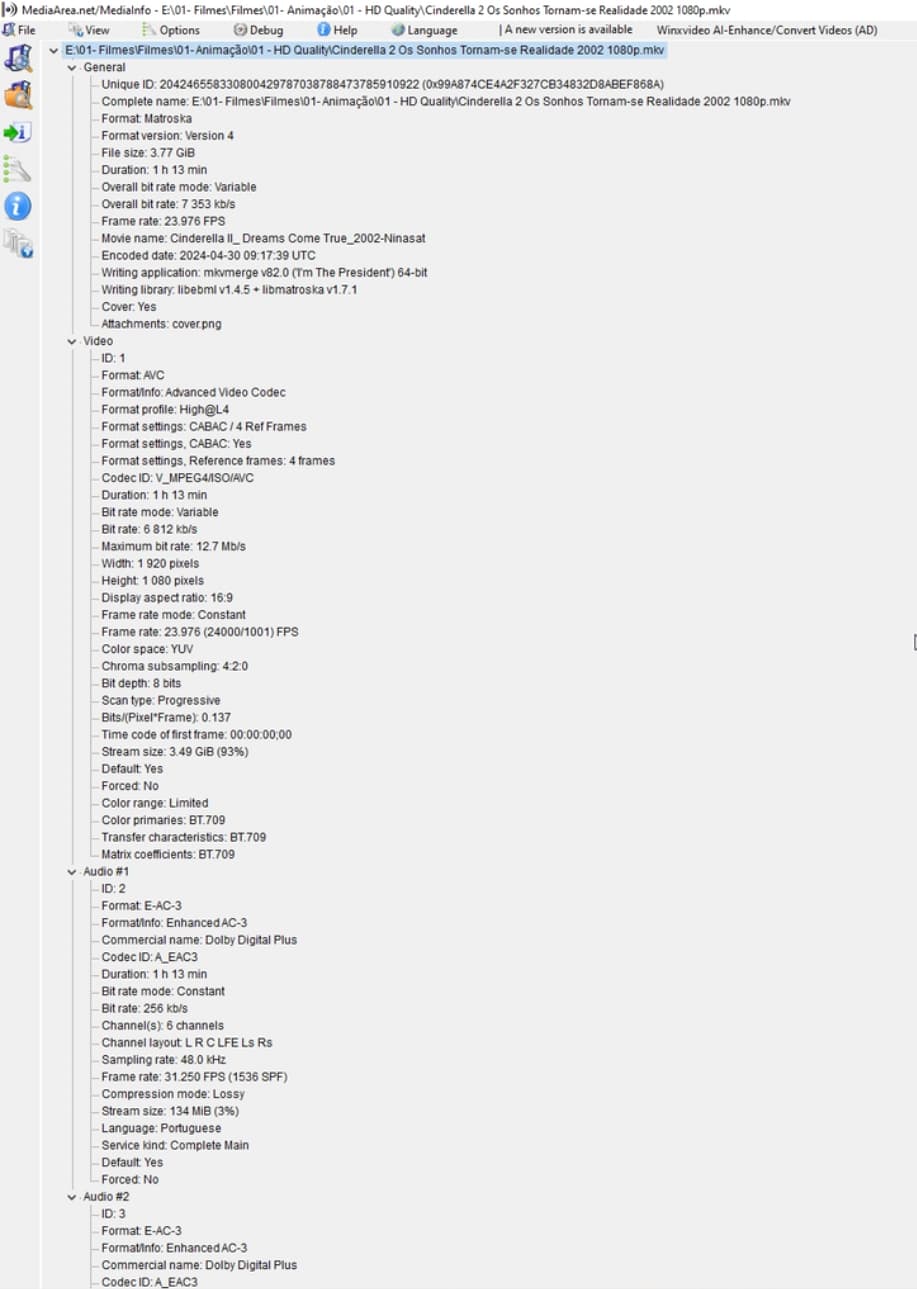

i will attach here the screen shots of the filo info of the movie Cinderella 2 (of the Plex’s ‘‘Get Info’’ and the Mediainfo software)
