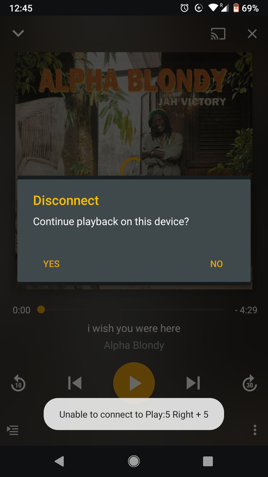

Now that we can cast to Sonos, any tips on how to actually get it work? I’m using a Pixel2 running Android 9.
  1. The zones correctly propagate in the list of castable devices.
  2. And the app certainly appears to have no issues connecting to the Sonos zone once selected.
  3. However playback always fails and wants to fallback to local playback.
  4. Playing to the same zone from within the Sonos app works so it’s doesn’t seem to be an issue with the Sonos network.

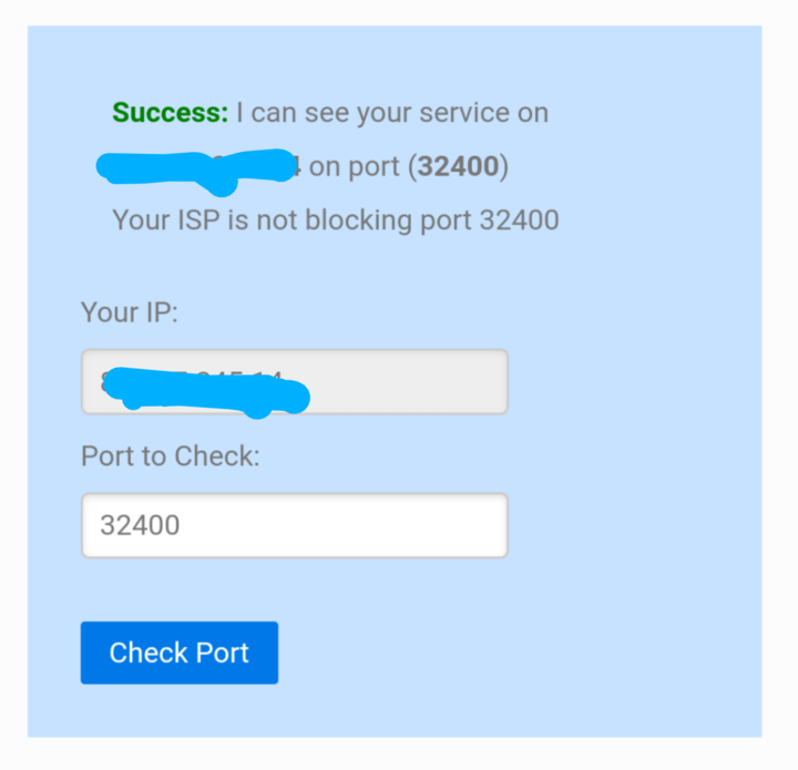

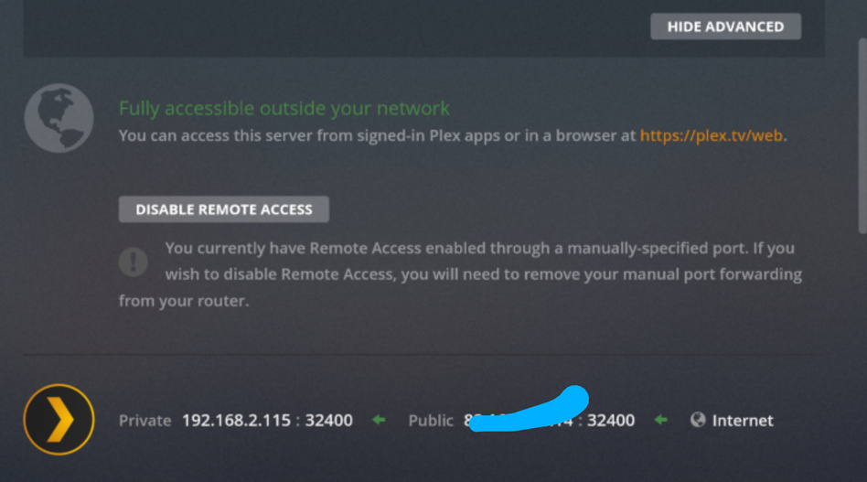

Just wanted to say thanks for the quick feedback from you and your team. After some discussion with my provider, I was able to get a public IP address again. After forwarding the requisite ports, I can now see my service again from outside, but the problem still persists.
Any ideas?
@wwwizzarrdry just a quick update - the logs show the same failure trying to connect remotely to your PMS. More unusual is that it’s somehow reporting multiple public IP addresses, which shouldn’t be the case. I’m following up with other teams internally to try to sort this out and will DM you, but it may not be until next week as I’m traveling for the 4th.
