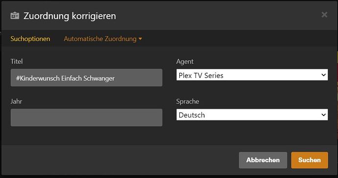

I try to change the search agent to thetvdb agent, because the plex agent wont find the correct metadata. but iam not able to change because there is no other agent to choose in the the dropdownlist.
please see the attached picture

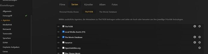

I have a issue with some tv shows an series when using the plex tv series agent, like incorrect or missing metadatas and and missing or wrong credits. the data in the tvdb are correct, but although i set up additional agents, the metadata, credits an names are wrong.
as you can see:

You don’t need to change the agent to search for something
If you use the Plex TV Series for your agent in scanner the 2nd screen shot you posted no longer applies to you
Your configuration is now done under the advanced tab of the library settings
3 dots next to the library → Manage Library → Edit → Advanced

As you can see, there is no option to choose “TheTVDB (Aired)”
That’s because you managed to switch the library to one of the older agents.
The episode ordering selector as described above is only available when using the new agent “Plex TV Series”.
