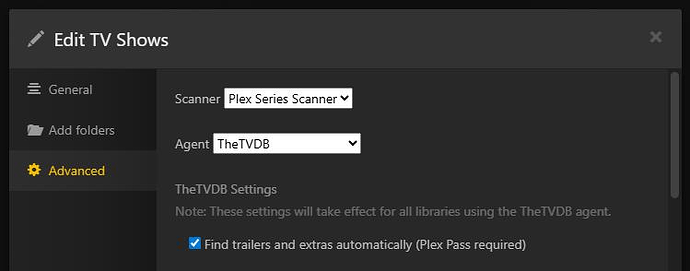

However, if I go to my TV library settings and force it to use the tvdb:
then everything is fine again!
I even tried unmatching and searching again with the “appropriate” agent, but it fails to produce any results.
I am keeping the TVDB agent as it works, but it produces this ugly red warning that I have to upgrade. I’m not going to upgrade, as the new system doesn’t work.

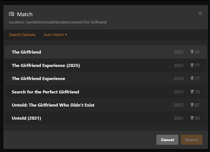

Using “tvdb-449706” in the search works for me.
The manual search and auto search look at different sources. Since you didn’t include the year in the search and pms by default ignores articles (“the”) so the manual search for just “Girlfriend” without a year can produce different results from the auto search. Include the year and it narrows the search and finds the correct show.

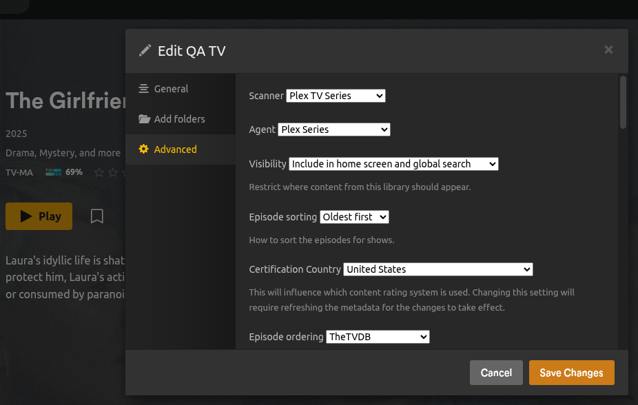

  1. Keep the names minimally simple:
[chuck@lizum tv2.2009]$ tree /glock/qa/tv/The\ Girlfriend/
/glock/qa/tv/The Girlfriend/
└── Season 01
    ├── The Girlfriend - S01E01.mkv
    ├── The Girlfriend - S01E02.mkv
    ├── The Girlfriend - S01E03.mkv
    ├── The Girlfriend - S01E04.mkv
    ├── The Girlfriend - S01E05.mkv
    ├── The Girlfriend - S01E06.mkv
    ├── The Girlfriend - S01E07.mkv
    ├── The Girlfriend - S01E08.mkv
    ├── The Girlfriend - S01E09.mkv
    ├── The Girlfriend - S01E10.mkv
    ├── The Girlfriend - S01E11.mkv
    ├── The Girlfriend - S01E12.mkv
    ├── The Girlfriend - S01E13.mkv
    ├── The Girlfriend - S01E14.mkv
    ├── The Girlfriend - S01E15.mkv
    └── The Girlfriend - S01E16.mkv
1 directory, 16 files
[chuck@lizum tv2.2010]$
  1. Library section Advanced settings
  2. Instant results.
Seee if this makes a difference: Plex Metadata not returning in Search for any Movie - Older Movies like Lethal Weapon Series - #3 by OttoKerner
I migrated my instance from Windows to debian install and it is now working. Not saying this is what caused it, maybe the restart might have worked, but the issue is resolved now. New agents work.
